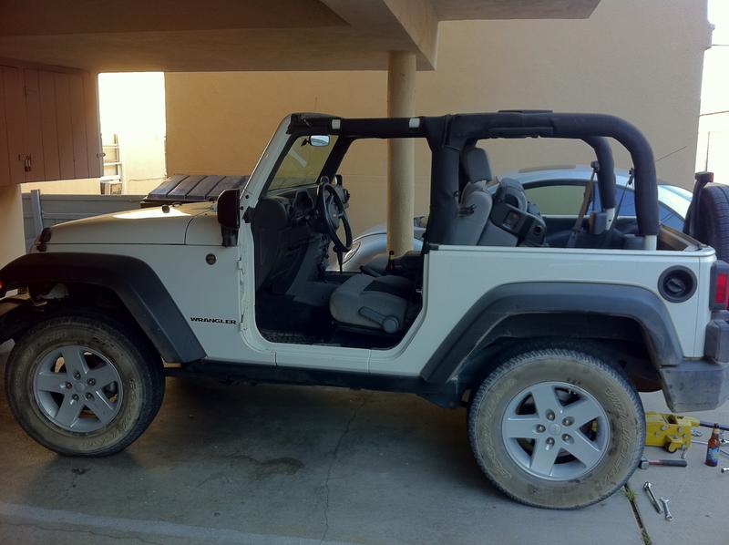

Hey guys, got a quick newb question. I just installed the Teraflex Leveling Kit and I'm wondering if I need to get wheel spacers to widen the stance since the Jeep sits taller now? I have a 2 DR 2008 and it's stock with the 5 spoke X wheels. I'm planning to get new wheels and tires soon- should I get tires with a more negative offset? Planning to go to a 33"
Any advice would be great!

I'm thinking of adding spacers too. Think it would look pretty sweet.

Personally I don't think you 'need' to get spacers when you install this kit but I think it looks better with the wider stance so I got a set of Spidertrax. If I could afford it I would (and probably will one day) get a set of rims with the proper offset though.
