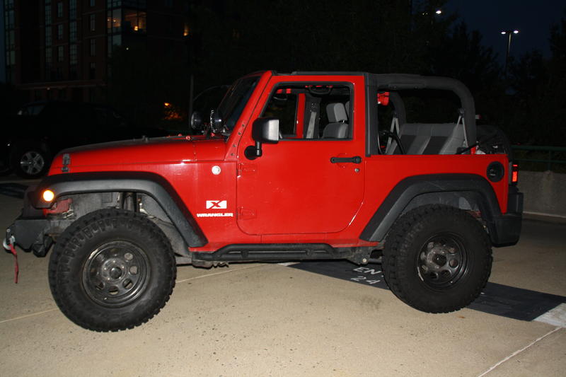

Old Aug 30, 2011 | 03:27 PM
Bernigoober's Avatar
Posts: 345
From: Orlando, Fl
I have the performance leveling kit. It's the one with coils, not just spacers (http://www.teraflex.biz/jk-1-5-perfo...-kit-1424.html). I can't seem to find a good picture on this computer. I'll try and get one up later tonight

Old Aug 30, 2011 | 04:22 PM
Posts: 345
From: Orlando, Fl
Sorry if this picture is not the best. I just took this out on the parking garage, hope it gets the point across.

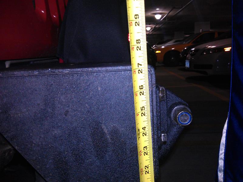

Karl, I run down and measure that for you in just a bit

From: Orlando, Fl
Hey there again bud, can you take a measurement of your TF performance kit at the top of your RR bumper? Right there on the flat part. I want to see how close I am to the leveling kit with just 4dr coils.
It's right around 27" to the top of the RR bumper. I'd imagine if my tires were actually 33" it might be a little taller. Next time I have to buy tires, I'm gonna get a size up. Hope this works

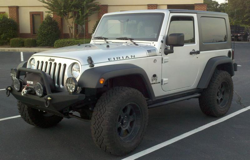

Old Aug 30, 2011 | 05:48 PM
OH9JK's Avatar
Posts: 3,796
From: Stokesdale, NC
TeraFlex leveling kit and 33" Duratracs. My Jeep came with performance spring / shock group and factory hardtop so it sits up a little taller than some.
Great ride w/ good off road performance!
