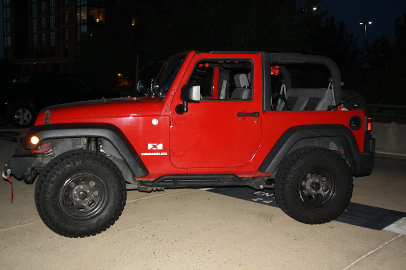

That works perfect, my "31's" measure up to 29.5" but you still have a solid 2" on me. Mine sits a touch over 25" in the front there. Thanks again, looks like I should get an actual leveling kit sooner or later.
I think the difference is only in the tires. my 33's measure to just about 32"...If you were to toss some larger tires on there I think you'd be good to go.

Originally Posted by Bernigoober
Sorry if this picture is not the best. I just took this out on the parking garage, hope it gets the point across.
Karl, I run down and measure that for you in just a bit
Attachment 204532
This is a really nice look, especially if its a daily driver, have you noticed any fuel economy fall off going with the leveling kit and 33's?
