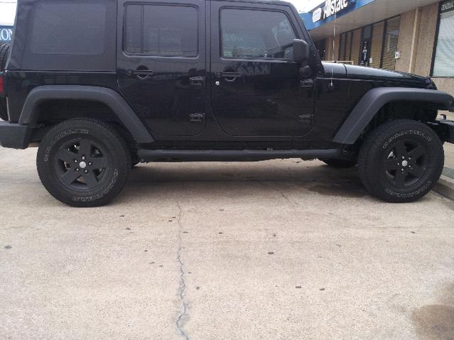

Before...

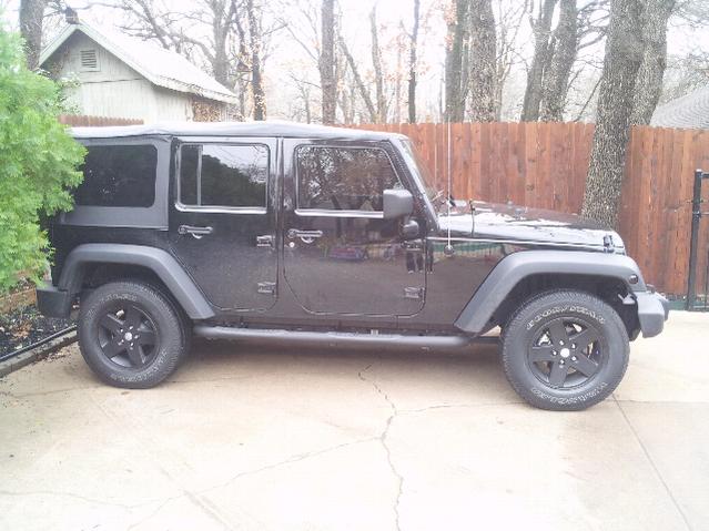

And after...

This was my first ever attempt at this large of a project. Thanks to all the helpful posts here it went relatively smoothly. I started at 11p last night and finished at 3:30a. Would have been faster but I couldn't get the frame end of the new sway bar links tightened! I think teraflex's design leaves a little to be desired as the factory link can be held on the inside edge with a 19mm open end wrench but the only thing I could figure on the new links was to use vice grips between the bracket and the bar? Anyway, its tight now and the kit seems really nice overall.
I netted just over 3" in front and 2" in back with the kit plus takeoffs (new springs were 18/59 and stock were 17/58).
Now I need bigger tires.......I think this sickness will never end
