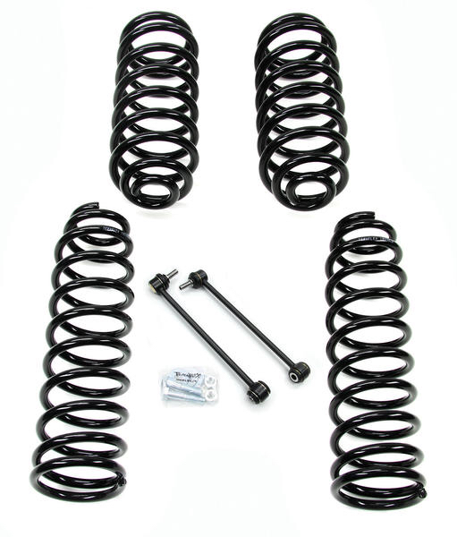

I will install the TeraFlex leveling kit, which includes a 2" front spring, and a 1" rear spring with longer front swaybar links, on my 2013 JKU Sport (auto trans).
Is it worth spending the money to upgrade my shocks now too? If I upgrade shocks, does that open the door for other necessary parts like shock relocation brackets?
This is my daily driver, I don't do a ton of off-roading mostly just light trails, and don't plan on going any higher or getting 35s, etc.

With light trails you will be fine with the.stock shocks.
I run the same kit with 35s and the cut/ flat fender mod .
I had to add 1 more.inch of.bumpstop to keep tires from rubbing.
If you do upgrade shocks later just get the 0-2 inch lift shocks and you shouldn't need any new brackets .
I do like the rear shock relocation brackets that raise them at the axle on the rear. Gets rid of the rock draggers stock mounts.

When I put mine on ('09 JKU X) I upgraded to Rubicon Shocks and added the tereflex greasable Quick Disconnect sway bar links. At full flex my 33s rub the front fenders. Flat fender flares should resolve the issue.
The TF Products have been of high quality. The Quick disconnects are not the easiest to get on and off, but do the job. I like that they have upper mounts to hold the sway bar out of the way when disconnected. They are well thought out in that regard.

Like others had said, you may want to get longer LCAs eventually. Won't be terrible but I did notice some flightless at highway speeds with stocks arms. The teraflex disconnects will be a great addition for off-road capability. You don't need to buy the whole kit which is $125 because the links that come with your kit are the same. Just buy the the pins and upper mounts on teraflex site for about $35. I did wheel spacers as well I noticed some additional body role after the install. Not much but the wider stance felt better and if you go with larger tires you will need to. Somebody else mentioned bump stops. I used a hockey puck(s) and a lot of people do. If you do decide on discos, you may want to consider longer shocks and limit straps. I think I also feed up the brake lines in the front and zipped them to the shock when I did this. If I remember correctly the brake lines became a limiting factor with the discos and that is bad. Measure everything well before you go for it. Extend and compress everything and see what hangs you up. Look up shock travel specs and write your heights and such down... You'll want all that stuff for reference after the fact. Have fun.
