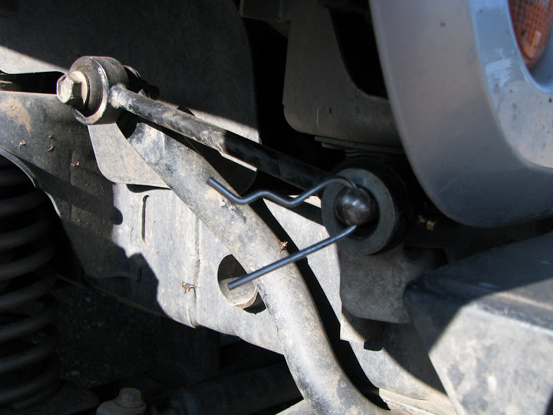

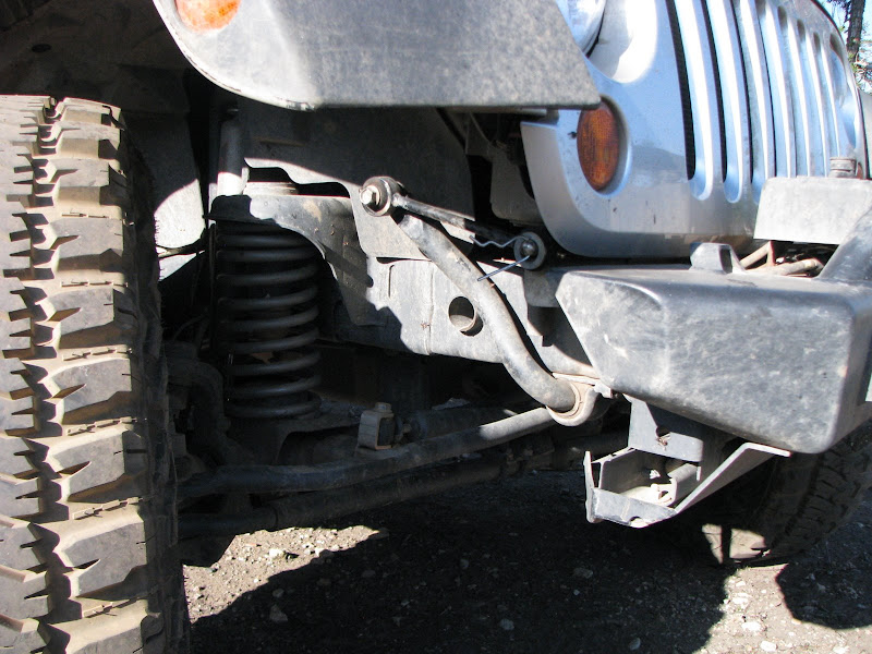

Does anyone have a link to a thread that was posted awhile back in regards to the teraflex quick disconnect pins getting bent up? I can't seem to find it or any comments on how to keep it from happening again (I've already replaced one pin and bent two others back into shape)
This probably had something to do with it...

Clips are sold at home depot. Looks like you inserted them way too far. They should only be as far as the first "bump".
I bent mine quite a few times until I started putting them in the other hole...instead of the one in your pic....and only put them in till the first bump....and I bought them at home depot....now trouble free for over 2 years!!
