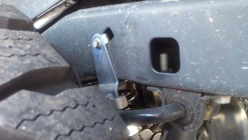

Just installed the 2.5 coil lift and noticed that the rear brake line bracket is rubbing on the rear sway bar. Is it mounted in the wrong place or wrong way? Is anyone else having the same issue? Not sure what to do about this

Is that after relocating it with the extension.. I have 2.5" and my break line sits fine. Almost looks as if you need to adjust your sway bar...

Can you take a side angle pic.....

I may be wrong, but it looks like you have it mounted wrong. The lip us supposed to sit inside the frame to secure it...

quick pic of mine

His mount is sitting awfuly low compared to yours...

OP, take some better pics. more than likely, something is installed/adjusted incorrectly.

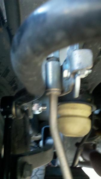

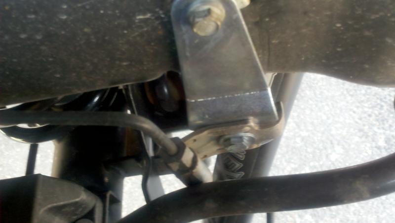

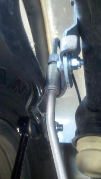

X2.... Can you take a pic of opposite side as well...

Default here you guys

wait a minute. Its mounted backwards isnt it
