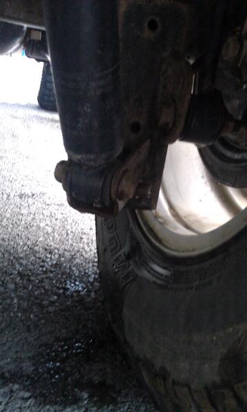

Check your rear shock bolts aka these..
My bolts wore loss and made all kinds of noise
