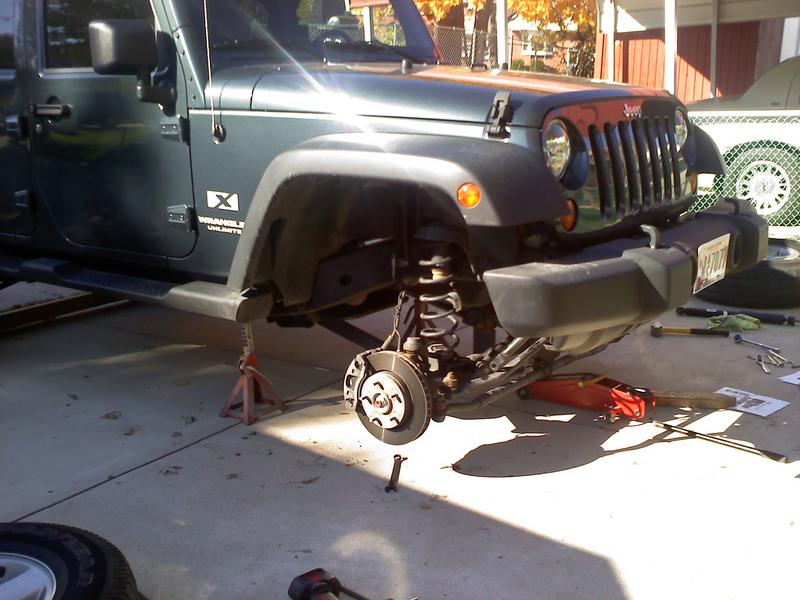

If you run into issues ...call off sick. If you have all the tools and parts then go for it. My wife helped me with mine...it was fun. Like I said you can wait on the rear track bar bracket ( have to drill and strap it over ) till the weekend. The front top shock bolts on mine were a little rusted and needed soaked down some but the rest of the bolts were easy.
ID:	123658   Click image for larger version
