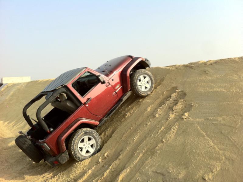

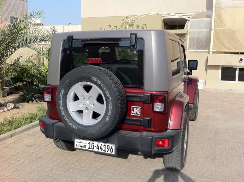

Hi all , my 2010 sahara is 9 months old and its time to go bigger
This is what i have in mind for now:
-315-70-r17 BFG A/Ts (34.4") on stock 17 wheels
-TF leveling kit
-1.5" wheel spacers
and later:
-Flat fender flares
-XHD front bumper+warn winch
But
1- its a 6-speed , do i NEED to regear right away ?
Its my DD but i dont do alot of highway driving
2- i already have 1.5" wheel spacers fitted on and TF leveling kit in the garage , will the 35"s fit on the stock fenders+bumper for a while ? (its a UK front bumper)
3- do i have to worry about the front axle ? 90% of my offroading is in sands , only 10% rocks
Thanks
