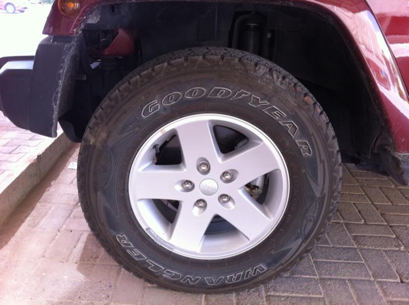

Yes to your pinch seam question, directly in front of the rear tire is what they're talking about. I have a pic of mine with 35's and there is 1" of space on level ground.
To your bumper, is it possible for you to clip the ends of it? I think it'd be fine for straight driving but I'm thinking that when you turn that you'll contact it there (if you can visualize the mass of tire rotating there. Also, think about how much your nose drops when you drop it into reverse. Are you going to be able to turn and put it in reverse??
My stubby bumper alleviated these issues for me so I can't say for sure if you'll rub or not.
Pics to maybe help
this was just 4dr coils, wheel spacers, and obviously my stubby bumper.
Try to draw a line down from the flare, unfortunately these are the only pics I have on the phone.

It depends how your sand wheeling is. Honestly- here it is really flat and there isn't a lot of suspension travel needed. So I would absolutely get the leveling kit and run 35's up and down the beach all day. You'll want bumpstops to keep the tires off of your fenders but if it doesn't bother you then you don't 'need; bumpstops. With the rubi wheels and wheel spacers I had no rubbing on seay bar links or any os the suspension on flat ground.
This was a very temporary situation since they're actually my friend's tires but he was nice enough to let me borrow them for a day to see how it would work. As far as flat fenders go, they are needed when you are doing some crazy flex but you have no desire to rub your flares. Again, to be honest- if I rip off a flare then I wouldn't much mind. But clipping your stock fender flares will achieve the same end result.
Now if you're doing jumps and all that in kuwait then you will really want the bumpstops and such.
