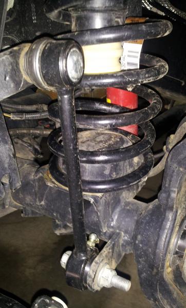

Incognito's Avatar
Posts: 437
From: -
Here's a picture of mine, hope it helps.
BTW, I ended having to shorten the top bolt by about 1/4 inch for it was rubbing on the spring bracket.

backwoods's Avatar
Posts: 191
From: Brandon, MS
That is not what mine looks like. One end has the bolt made into the ball joint. The upper end, according to directions, and will not pass through the hole in the sway bar.

RoysRig's Avatar
Posts: 1,476
From: Mile High Colorado
The holes need to be opened slightly. I used a file to open mine up. I think everyone had the same problem with the bolt not fitting. But only took me about 30 seconds of filing to make them big enough to fit the bolts in.

RoysRig's Avatar
Posts: 1,476
yeah yours does look different than mine. There is a stud instead of a bolt on the top. Mine is for a 2012.
