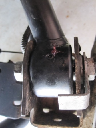

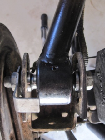

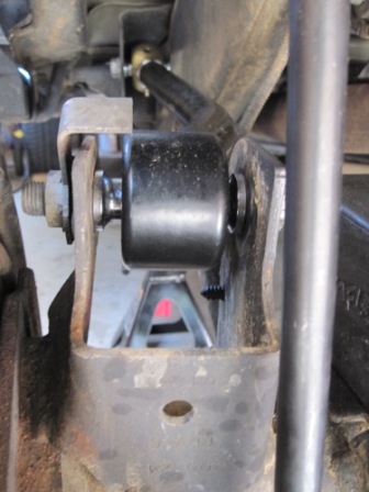

I installed these and started to torque the axle bracket end and noticed the bracket bending. Is the sleve inside the Arm supposed to crush and shorten as the bolts are tightened? Is this a defective joint?
I have attached pics of the drivers side(not tightened) vs the passenger side(still not torqued to 125).

I dont think this is right.
PM Joe @ TeraFlex
Can you get closer on the pictures?
The inner ball/sleeve should be 2-5/16" wide, what do your measure in width?

Thanks Joe, I sent you an email.
Old Aug 26, 2010 | 06:46 PM
Claydigger's Avatar
Posts: 23
From: West TN
Joe and TeraFlex Rock!
Their customer support is really good. They sent out a new set of arms and are sending a call tag for the arms I had a problem with. Joe answered several questions that I had too.
