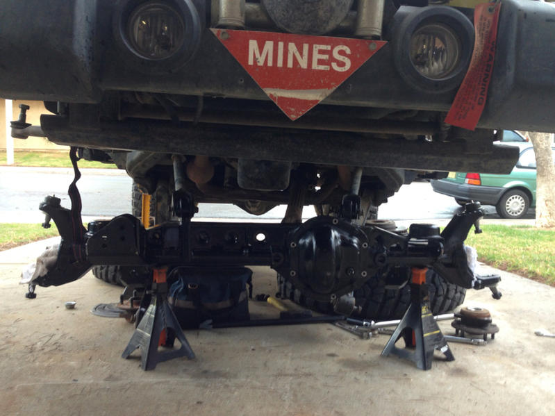

Hope so!
You have to weld it to your pumpkin which is cast steel. This is a big deal to do right.

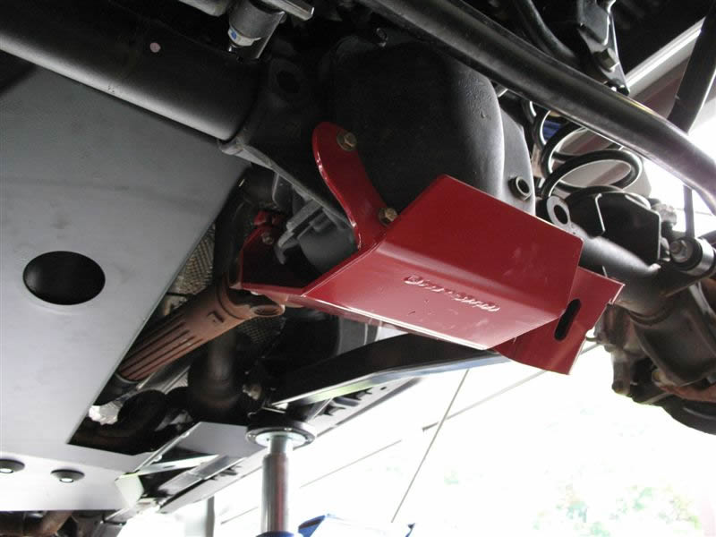

I literally just threw the rancho front diff skid plate on this weekend. Will I still be able to use it with this?

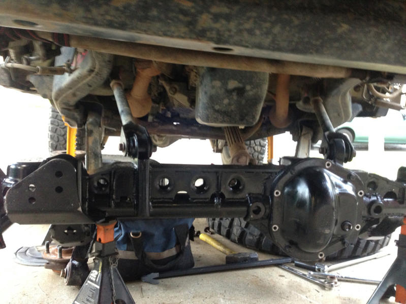

I deleted all my other photos on my phone so I only have these. The truss was the first step, welded on along with the lcas and C's.

no it uses the 5 bolts on the bottom half and also uses a u bolt to site behind the pumpkin on the DS. nothing ontop though
not the best pic but gives you a rough idea of what i mean

That should work fine. The truss is only on top.
