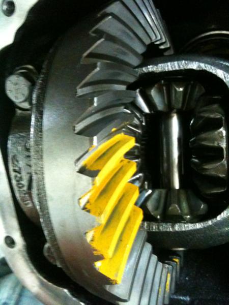

I did and I have to say that I hate crush sleeves. Holy crap it takes a lot to crush one. The only issue I had was pinion nut related. It's a bitch to take of and a son of a bitch to put back on :-) everything else was cake work...
