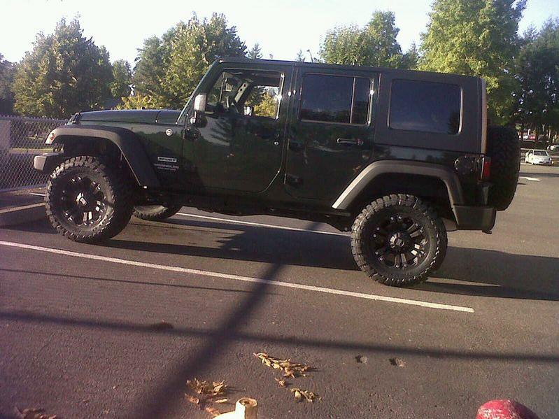

Here is my buds with a 2 1/2 Teraflex coil lift and 33'sClick image for larger version

Originally Posted by RAINSTATEBEAR
Here is my buds with a 2 1/2 Teraflex coil lift and 33'sAttachment 94405
Hey man do you think you could get more pics of your friends JK? Thats the same color as mine and he has the same wheel i was thinking of buying so pretty much we have the same JK in mind. It would really help me visualize the end results of my dreams or wishful thinking... DUDE! Its like he's reading my mind..
