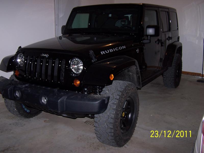

Default Pic and question
OK- the lift was easy as long as you just followed directions. I put it on two days ago and have no noises or problems!
I do have a few questions for you guys.
1) The front shock extensions have a large washer that goes down over a ledge on the extension to be followed by your lower rubber washer for the upper part of the shock. I didi not find them with my kit until after installation so I put the factory lower washer on. It sits on the part about 3/8"- 1/2" higher with the same amount of surface to grab. WIll there be any problem here? I am going to buy new OME, Fox, or Bilsteins in a few weeks. The ride is fine. I am guessing it is just compressed 1/2" more.
2) On what I perceive to be flat ground I measured my fenders to see it level. It seems the front is maybe 1/2" taller than the rear. Yes, I did put the factory isolator back on top of the springs. Maybe it is just level now and I am used to the normal rake of the factory look.
Any thoughts on either of my questions would be much apreciated. Even your thoughts on shock selection. Click image for larger version
