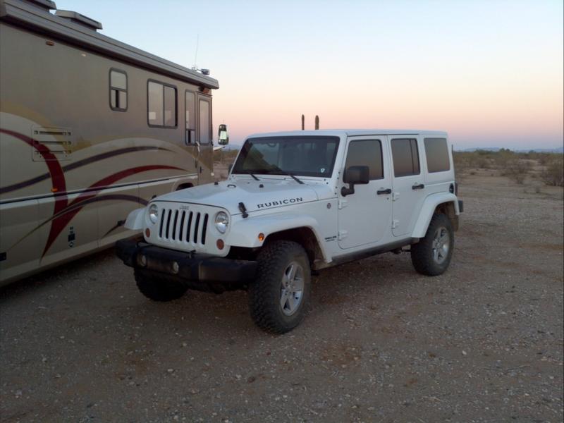

Your Jeep looks awesome, I have the opposite version, all white 2012 Rubicon. I'm planing to do the same lift with 33's. Did you need the exhaust extensions? Also did this kit come with the longer sway bar links? I'm suffering with the same lift kit info overload.

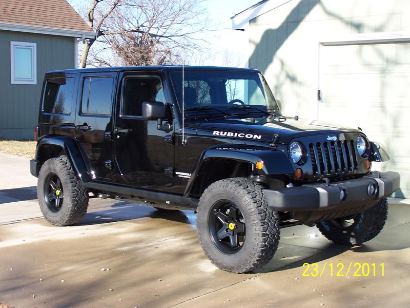

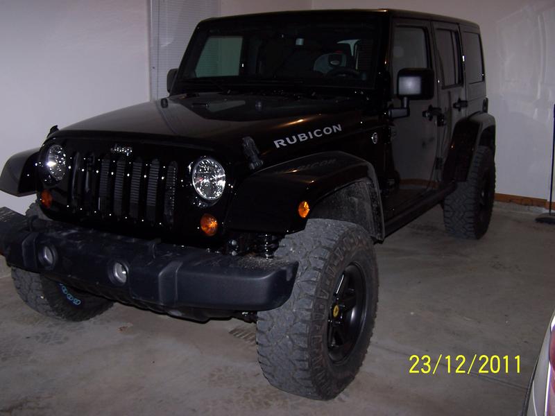

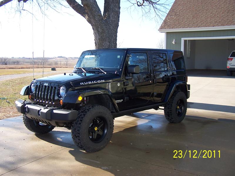

Gratuitous driveway shallow water crossing pics- no flex... Click image for larger version
