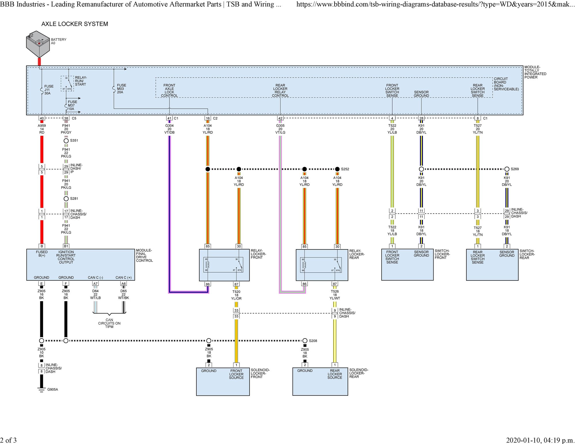

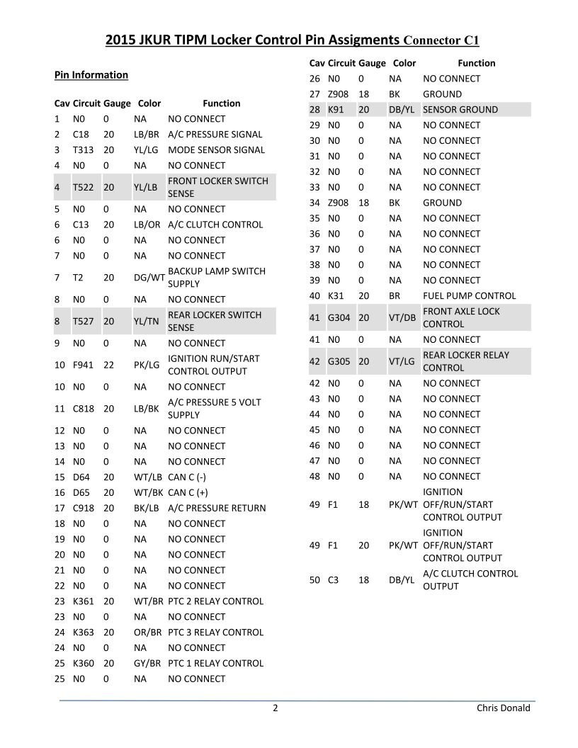

Hopefully the attached info will help if you are doing any 2015 JKUR locker mods.

I've saved this. I hope that I never need it, but could prove invaluable if I do.

Excellent info...
Just what I was looking for. Apparently on the wrong forum. HaHa. as those on JKOwners aren't updating posts with this kind of info. Only questions.
Can you explain how you wired it, and what your expected result was?
Example; Was it only to do a locker bypass and be able to select lockers in 2H and at any speed?
Or did you also wire it so that the dash light goes solid and not flashing? Or... ??
Thanks!! As I'm about to embark on similar and thinking to delete my sensors (because I mistakenly pulled out the front when doing a truss and c-gussets - LOL).
