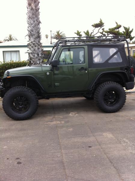

I just installed the flat fenders on my rig. I didn't use any more rivits than what came with the kit. The install was easy but took about 6 hours. Very time consuming. Marking and cutting the the wheel well plastic was simple. I used a sawzall and it worked great. Just take your time and follow the instructions. I am super happy with them. Good luck
Looks really good!
