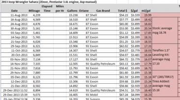

This is how my mpg changed with each modification. Please note I have 33" tires, not 35"s.
In case the pic is not large enough to see clearly, adding 1.5" lift took away 1.5mpg. Then adding 33"s took away additional 2mpg.
Notice, however, that because circumference of the tire is larger in 32->33 transition 0.5mpg will be "lost" due to that factor. 32->35 is a 9.1% difference, so figure 1.5mpg less only because you travel more per same number of shaft revolutions. So, your ODO shows you traveled less than you actually did. So, whatever mpg you get with 35", add about 1.5mpg to get the actual mpg, unless you changed computer settings to reflect larger tire diameter.
