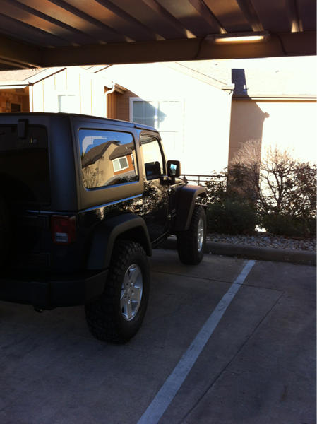

Here are the BFG 285/75 with 1.5" wheel spacers. In this pic I have 2" TF spacer in front and 1" TF Spacer in rear with 14/56 Springs. You can easily fit the bigger 35's with 2.5" lift.
