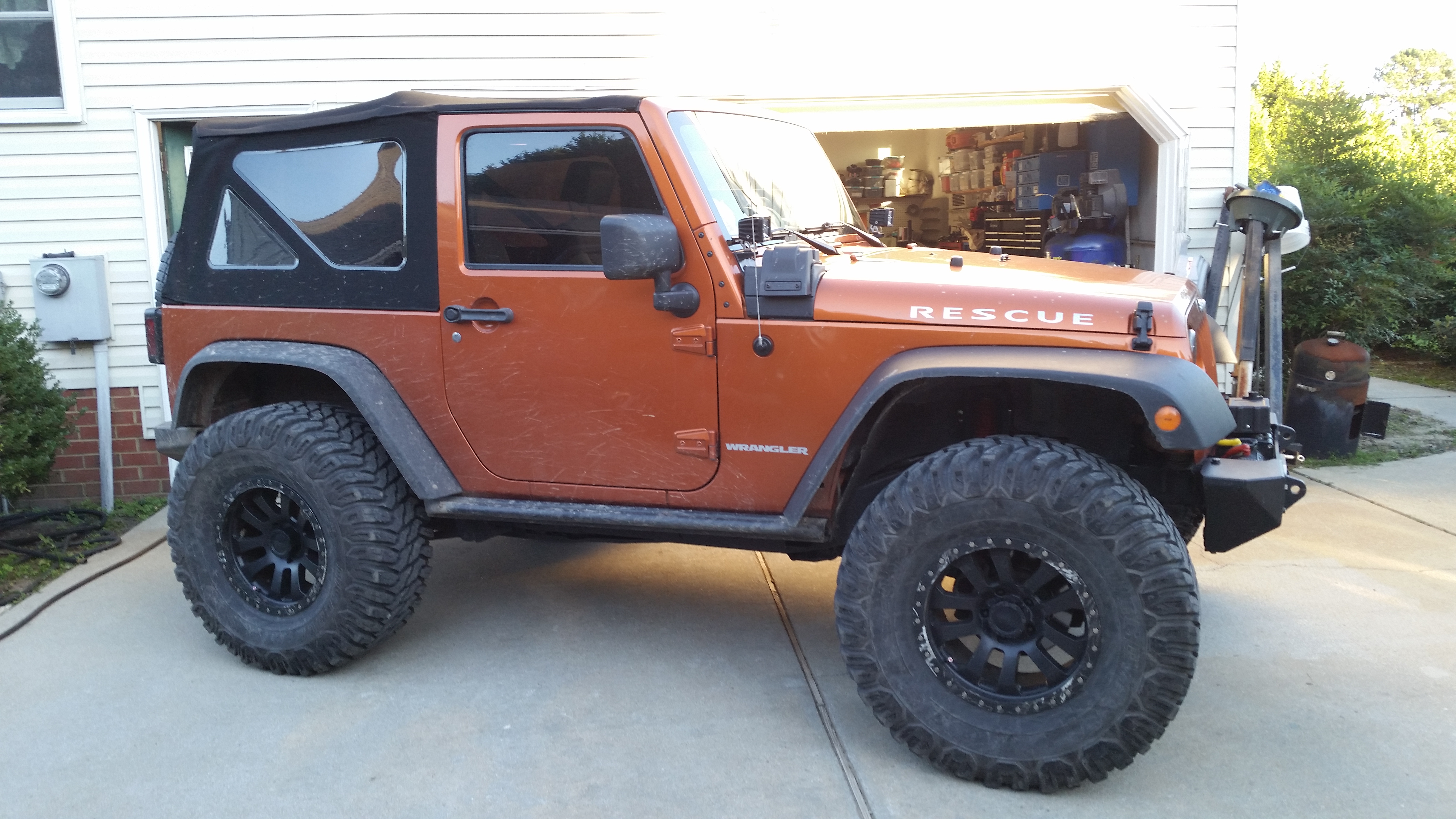

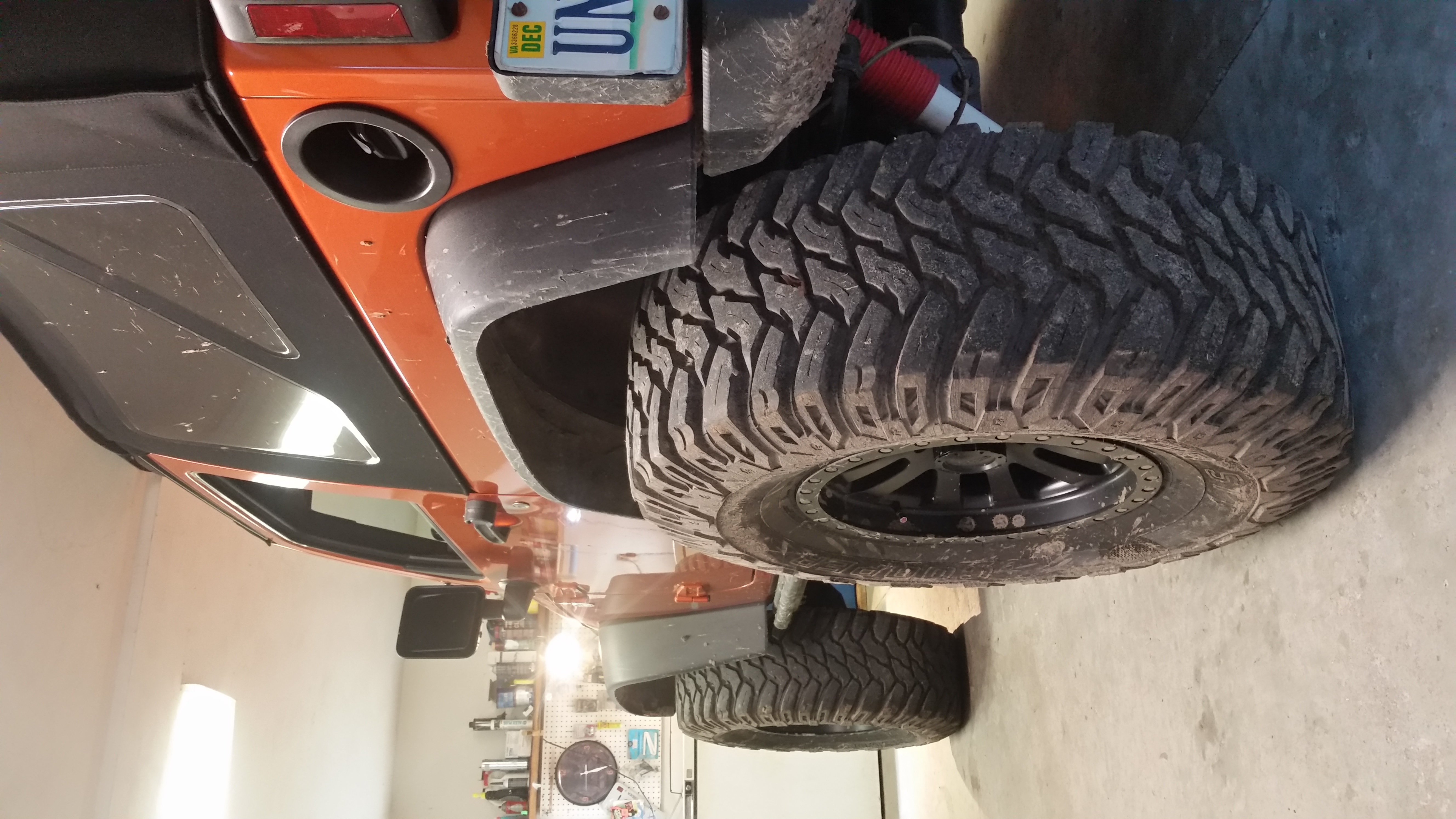

3.8, manual, 3.73's, factory chopped flares, and 37*13.5"- it looks awesome but needs regearing if I stay like this. Proportionately, it's everything you could want but I'm looking at going 35" from my 285's as well.

Aside from pulling a fender flare (which I think a tree bumped into the tire), it doesn't rub- even in a twisty ditch where I can usually find rub spots.

i like it, what suspension work have you done?

It's the 2.5" RK coils with 'some' weight, but not a ton. It's right at 2.5" and seems like less.
