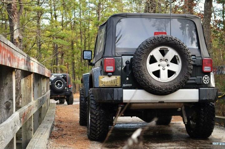

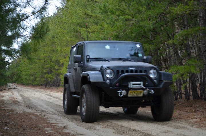

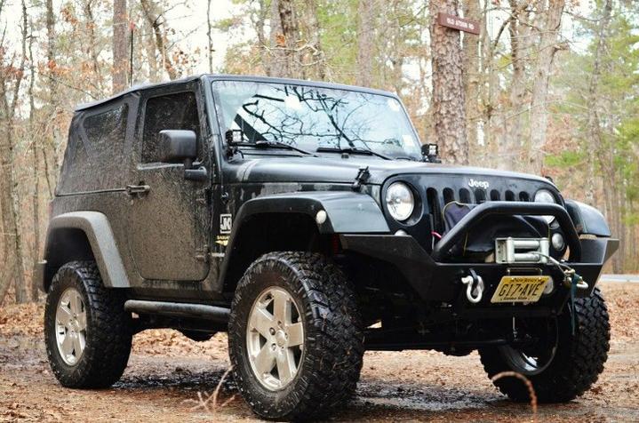

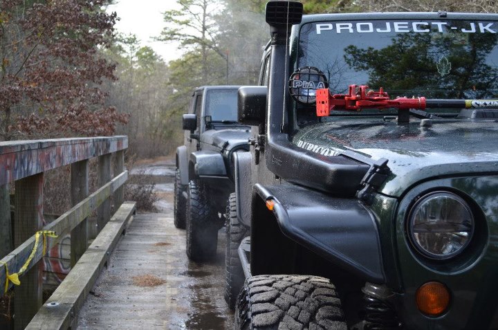

Here's my buddy Tyree's 2012 Sahara (forum member: Tyreelp)
2.5" Skyjacker sport lift and 3/4" Daystar coil spacers
1.75" Rough Country wheel spacers
285/70R17 Toyo or Nitto tires (can't remember which brand but it's one of them two)

His is in the back, my JKU is up front but it's a god angle at his tires
Hope this helps with a visual of those tires and the setup he has.

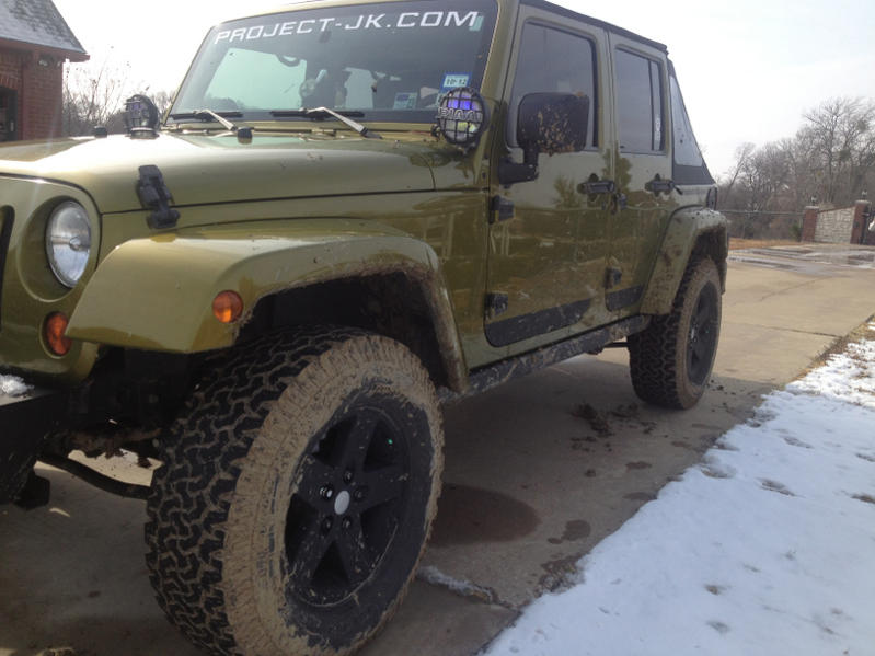

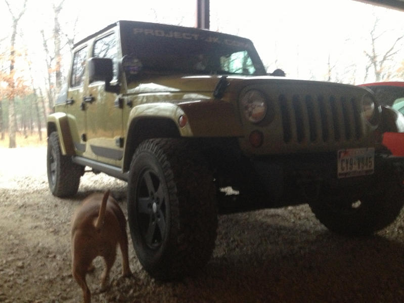

285/70/17 BFG A/T KO tires on stock wheels with 1.5" RC spacers.
Love them. ~32". Don't stick out too much.

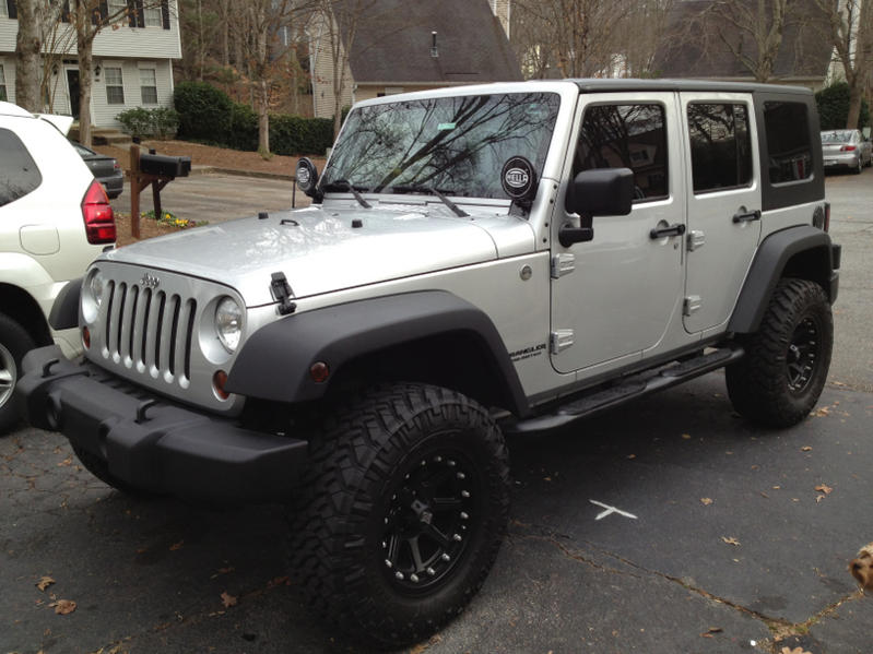

It really depends on your BS and wheel offset which will determine how much the wheel/tire will stick outside or inside the fenders. here are my 295/70/17 Nitto Trail Grapplers (mounted they are a true 33" tire). Wheels are 4.5" BS with -12 offset. They look awesome IMO and are great on the trail. However, they are a heavy tire. Somewhere between 92-94 lbs mounted on my xd addicts.

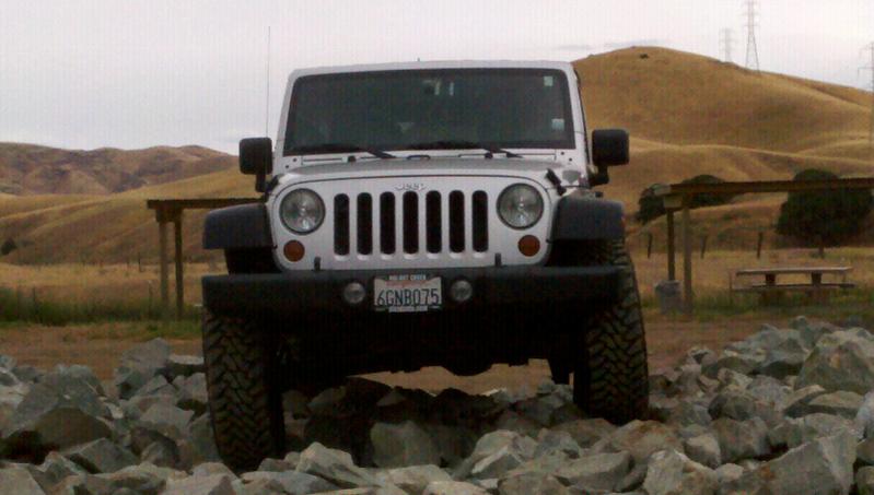

I also have 285/75/17 toyo mt with Spidertrax wheel spacers.I have 62k miles on them now and they measure 32.5 with that mini miles on them now.
