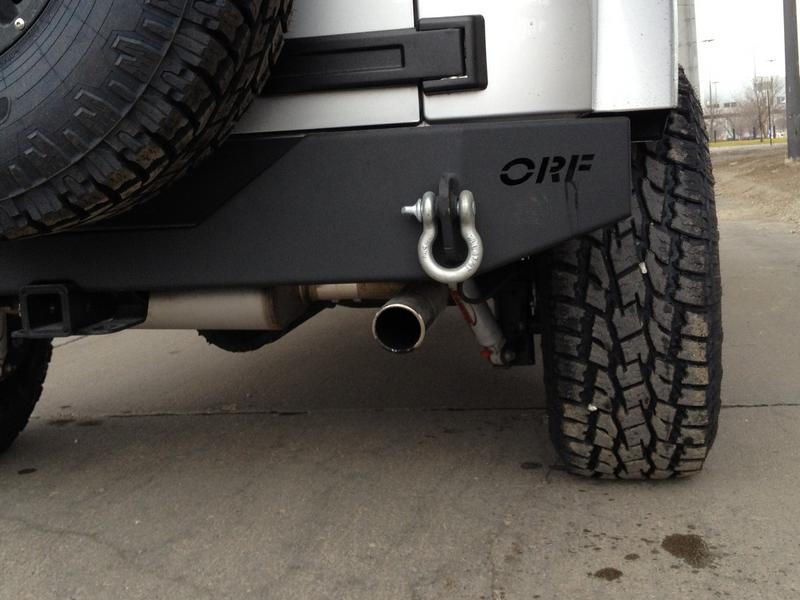

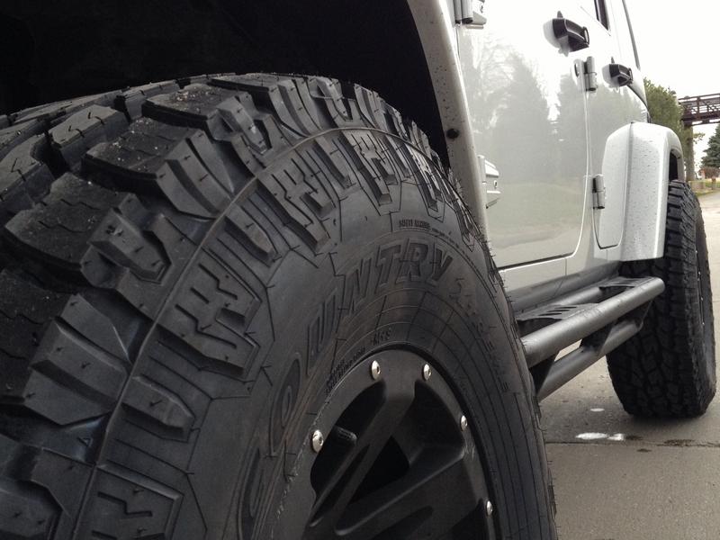

I think the MR-1s come in a 17x8 with 4.75" backspacing for the Jeep bolt pattern (I considered those when I was wheel shopping). That's the same backspacing as my Rugged Ridge wheels so take a look at the pics and that's how much you can expect them to stick out on a 12.5" wide tire.
I have Toyo AT IIs in 35x12.5x17... mounted and under the Jeep they measure just under 34". Like Cavallini said they're E rated, but I barely notice a difference from the D rated Cepeks I had on before the AT II. For how aggressive the tread pattern is I think they ride awesome on the highway, and the price is insane on them... the 35s cost $50 less/tire than my 33" Cepeks. Great in the snow as well (haven't had them in the mud yet so no help there). Would definitely check them out.
