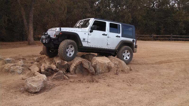

I have toyo mt 34" not 35s but they are like 97lb. Ea. Love them though 78k on them now.I have an 08 jku auto with 373 and i get about 15 mpg as i am convinced these are the best tires for me and for the Wheeling that I do as my rig is pretty heavy good luck with your choices.

Same tires new rims though. Tires lasted so long I could buy rims instead of tires .
