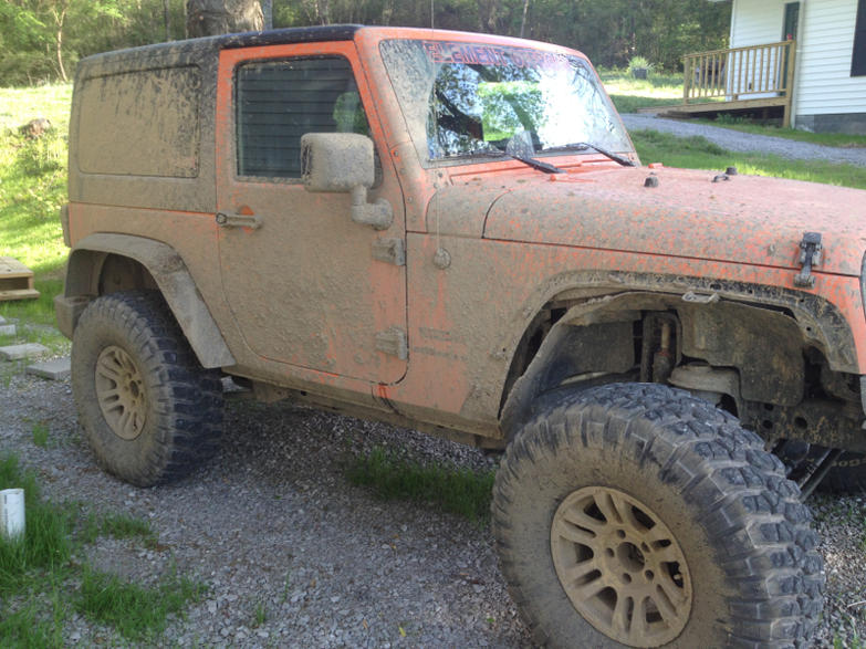

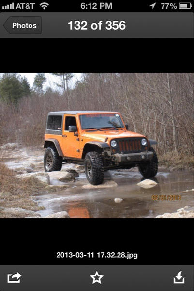

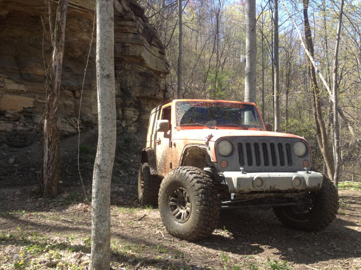

I dd 35's in my 2012 with manual and 3.21's. On road isn't terrible, but looking to regear soon, crawling isn't easy offroad. I put a pure jeep truss and gusset on my front d30 for about $200, that includes the $50 I gave a guy to weld it. My gas mileage went from 18-21 to 15-16z I wouldn't change it for the world.... Except for 37's
You can do a LOT with a jk on 2.5" budget boost and 35's. My cost to go from stock to this was around $2050, but you could spend $2000 just on a lift if you wanted. The budget boost get me thru plenty of black trails and is fine for me on road. 15" wheels will make tires about $100 cheaper each, but don't do it of you want to go 37's.

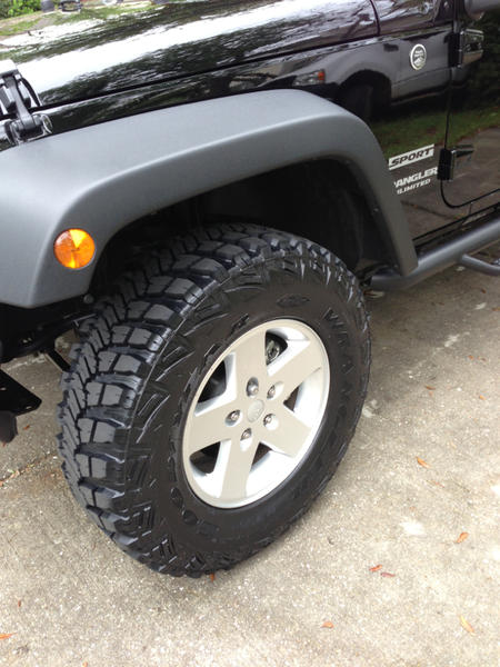

I went with Teraflex leveling kit, stock rubicon shocks and springs with 285/70/17 Goodyear MTR's. Aggressive looking, good ride quality, gas mileage didn't suffer much and no rubbing even at full lock.
