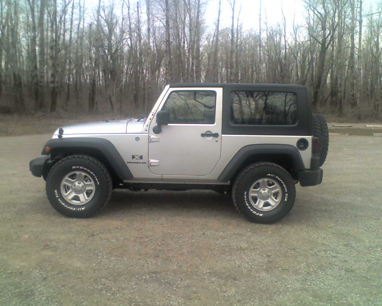

Originally Posted by jnorton1
Any pics on stock ?
Yep, here's mine before my lift was installed..
The tires were the first upgrade I did.
Have fun in your upgrades..
so what size of tire do you have
