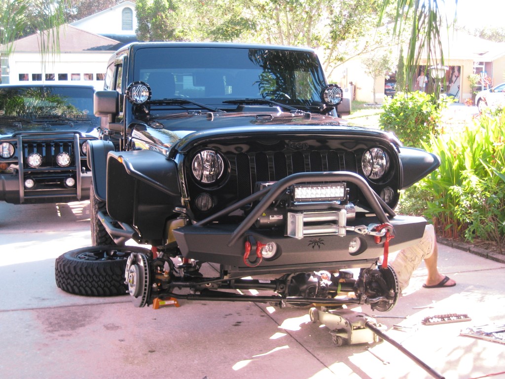

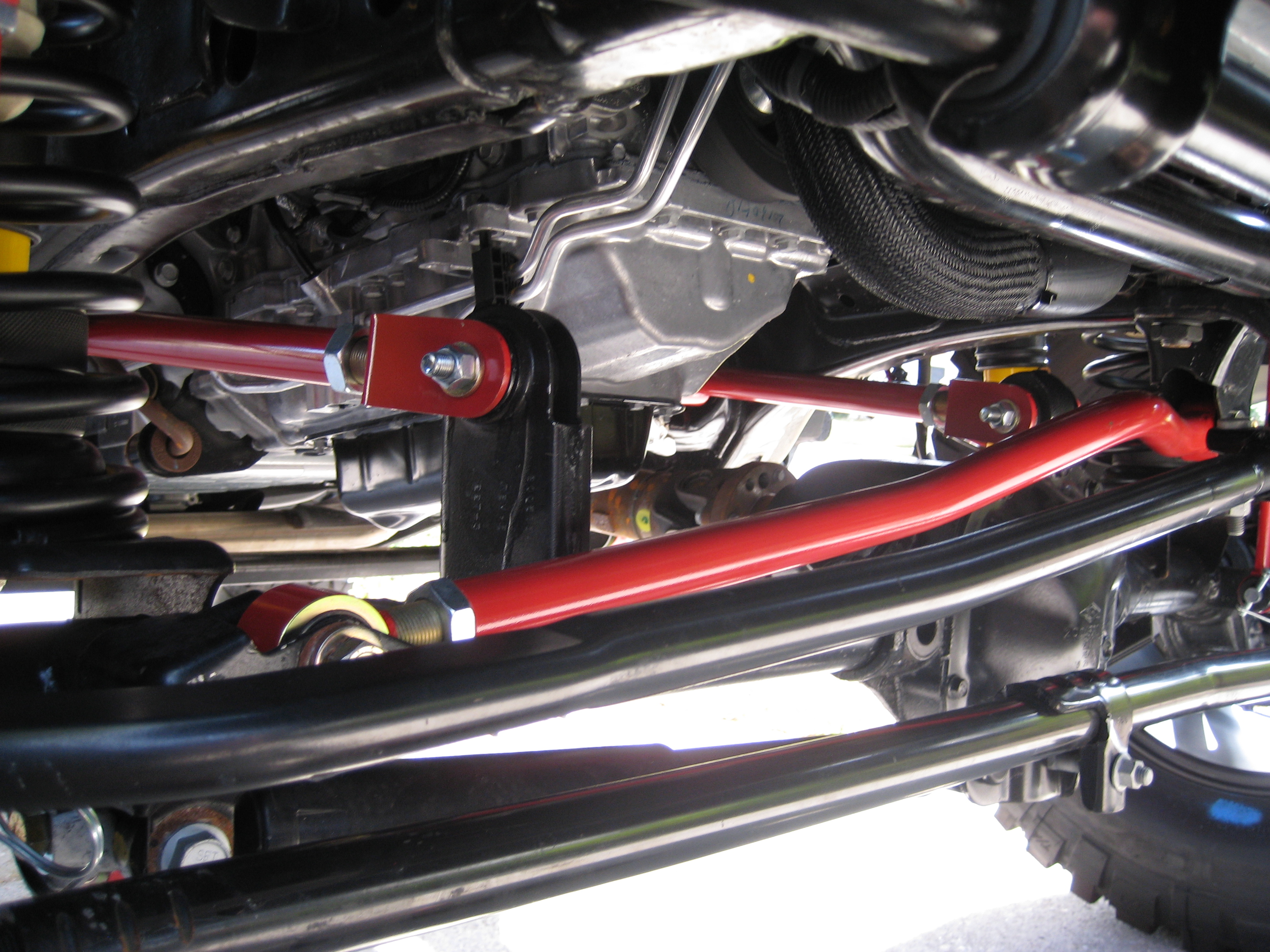

I had mine 18 days and it had 255 miles on it when I lifted it and put the 35s on. It took 18 days because I was waiting for parts from Metalcloak. My flares and sliders went on day 1 as my wife stood in the garage shaking her head as I was pulling the OEMs off. Other parts like sPod, bumpers, winch, lighting, safari straps, etc. went on day 2. And on day 18 my wife laid claim to my Moab wheels for her Sahara.
You can see how clean the undercarriage was at the time of install.
They cannot deny a warranty claim unless they can prove what you did caused the failure. If it did then you have to do the repair. But if it didn't, you are still covered.
