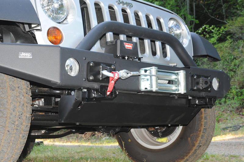

I need a tow bar that will work with the D-Ring brackets already on my front bumper. It’s a Rock Hard 4X4 bumper with D-Ring brackets mounted vertically right where the bumper bolts to the frame. They are super strong and should work OK for towing. Anyone seen a tow bar that could be attached to the brackets instead of adding a base plate or welding on additional brackets of some kind?

Something that is worth pointing out: The Shrockworks mounting tabs for D-rings are significantly stronger than pretty much anyone else. I've looked at quite a few bumpers, and other brands cut a hole in the bumper, then weld a piece of metal into that hole that can be inserted from front or back. The Shrockworks is actually a piece of billet that is enlarged in the back, fitted from the back, then welded around that enlarged portion on the back of the bumper, as well as around where it fits through on the front of the bumper (picture here). Unlike other brands of bumpers, it cannot be fitted from the front, and it cannot be pulled out from the front (short of deforming that solid billet).
Personally, I'd be concerned about towing a JK using some of the D-ring tabs I've seen. I would not have such a worry with the Shrockworks bumper. Having said that, let me also add that in four years on this forum I've never heard of anyone having a tab fail.
