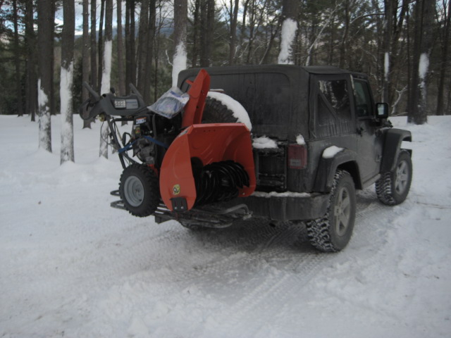

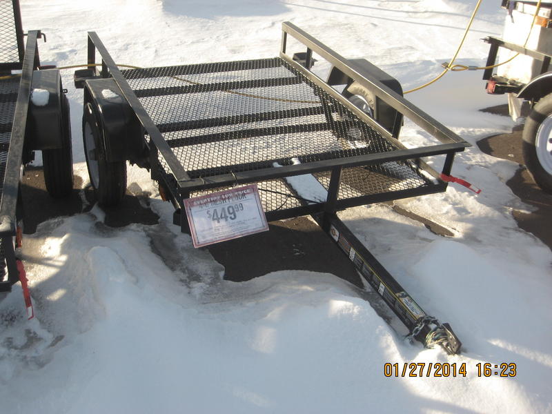

Default jeeps arnt made to tow realy
its hard enough moving their own weight & a few small items
little trailer and strap on the tent off you go

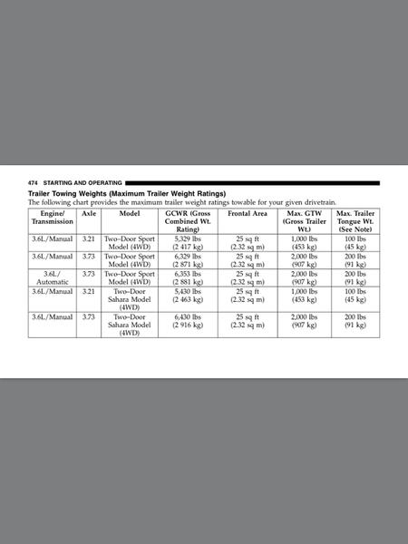

Originally Posted by Tooadvanced
Sure its not 2,000lbs?
My 2013 Sahara Unlimited with 3.21 is 2000lbs, same vehicle with 3.73 or better would max out at 3500 according to my manual. I guess the 2008 is different as mentioned.
The added horsepower made the difference. Not at first, though. The 3.6L JK owner's manuals up through the early 2013s still listed it as 4dr with 3.21 gears limited to 1,000 pounds.
The later revision to the 2013 brought it up to 2,000 pounds.
I suspect the lower rating of the early 3.6L JKs was a failure to properly edit the owner's manual.

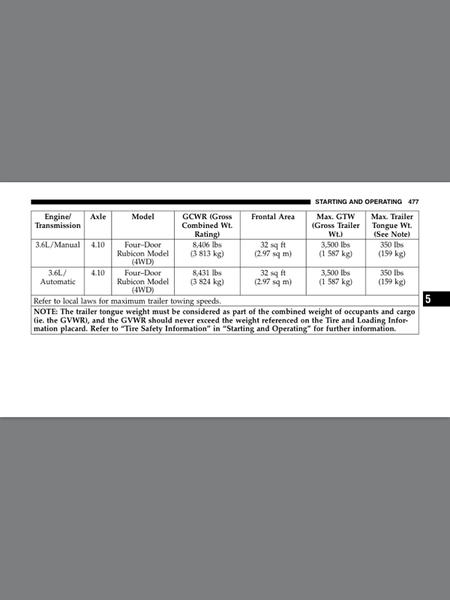

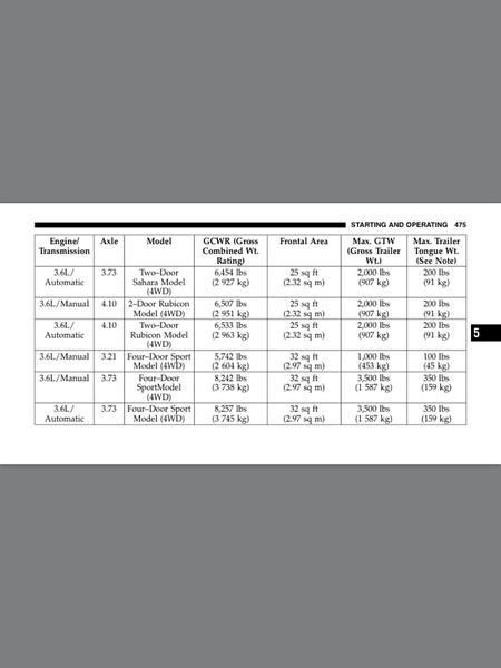

From the 2012 manual. I don't think I have ever owned a vehicle with various towing capacities. At least not this many....
