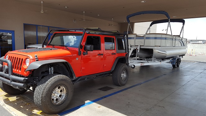

I tow a 24' Bennington behind my '13. I have 5.13 gears.... slow and steady I won't tow over 65mph. As long as your trailer tongue weight is correct you'll be fine. Also, if you plan on using trailer brakes you'll need to wire up a 7 or 8-pin connecter.

Speed won't be your issue, it's stability. Also the stock brakes are marginal. Pontoon boats aren't very aerodynamic, so you have to worry some about the wind moving it around a bit. Other than that, as long as you've towed in the past, you'll be fine. I've towed quite a bit more with my lifted 2dr on 35s. Far from unsafe, they just aren't great tow vehicles.
