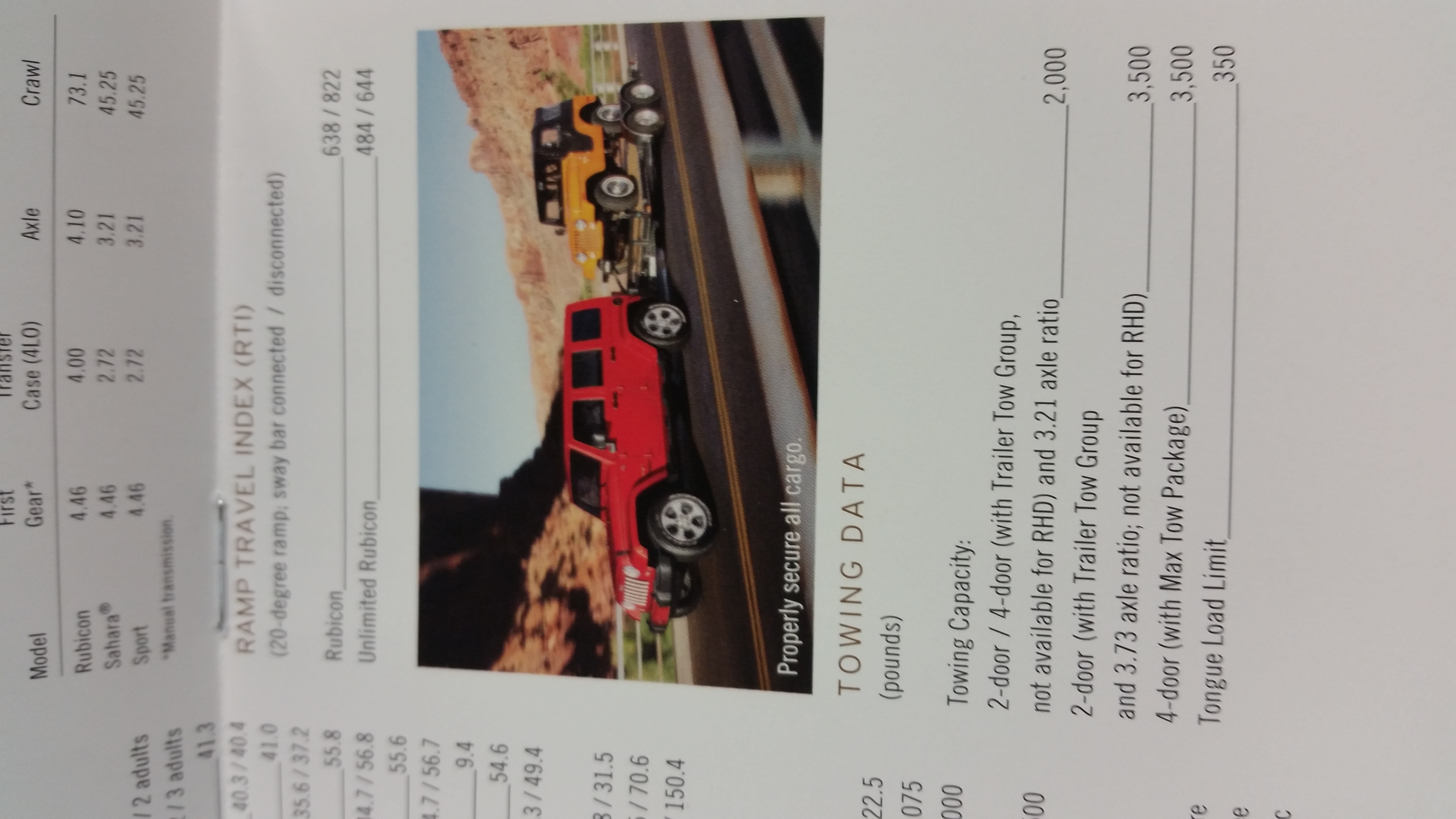

Originally Posted by austin160
3000# is over the GVWR for a 2 door. I think the max is 2k. A 4dr with a tow package is only rated at 3500# with a 300# tongue weight.
No longer true sir. This picture is directly from the 2015 sales brochure, note the weight limit if equipped with the tow package (likely a harness and hitch as years before).
Is it a great idea? Probably not. Will it work? Sure. I've pulled that kind of weight with an older JK and I live to talk about it.
