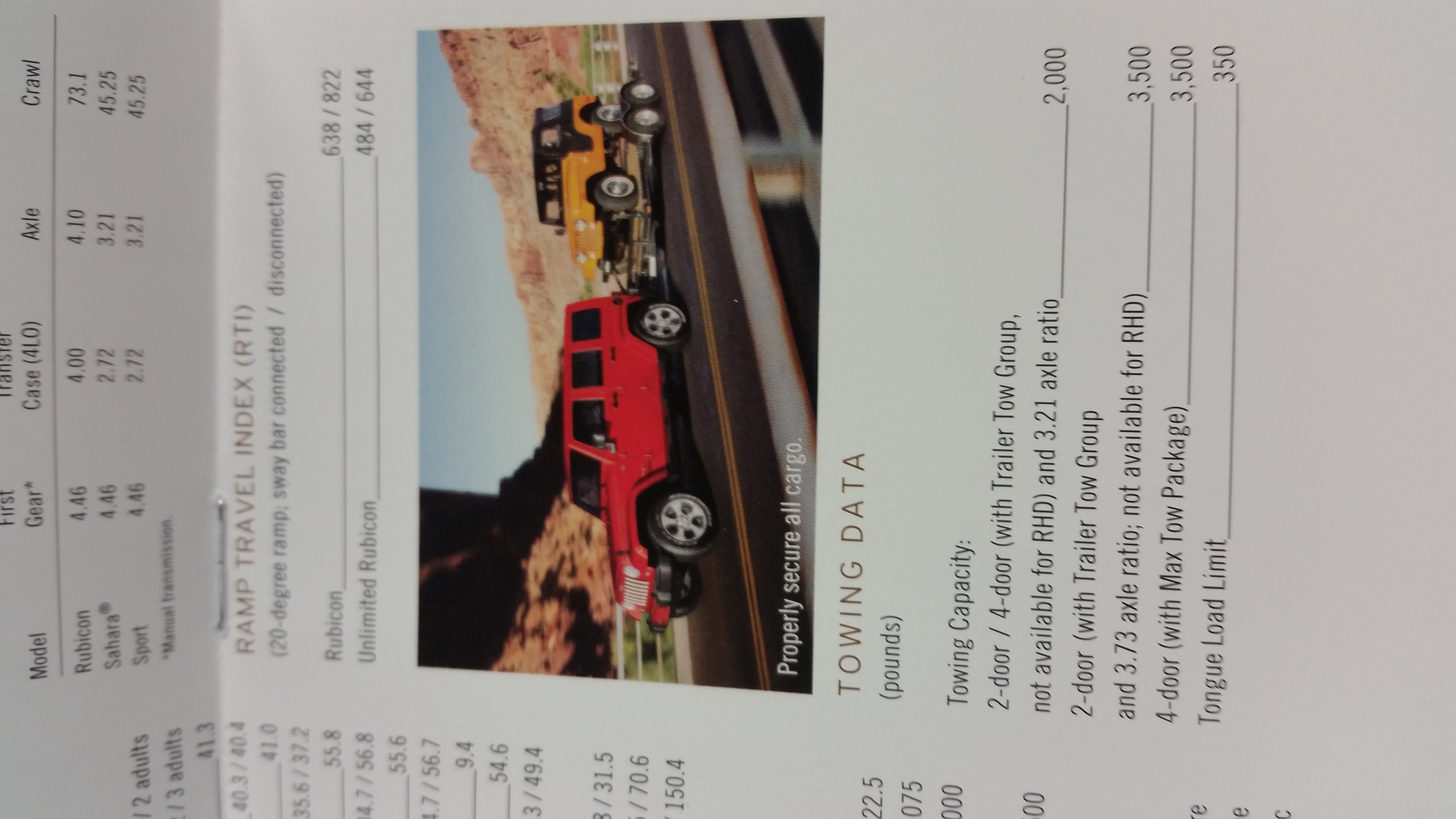

No longer true sir. This picture is directly from the 2015 sales brochure, note the weight limit if equipped with the tow package (likely a harness and hitch as years before).
Attachment 671448
Is it a great idea? Probably not. Will it work? Sure. I've pulled that kind of weight with an older JK and I live to talk about it.
I think this was an error. I have seen that before but Jeep corrected the owners manual on later 2015s. All 2 doors as far as I understand are rated at 2,000 lb and 4 door at 3500 based on the wheelbase.
