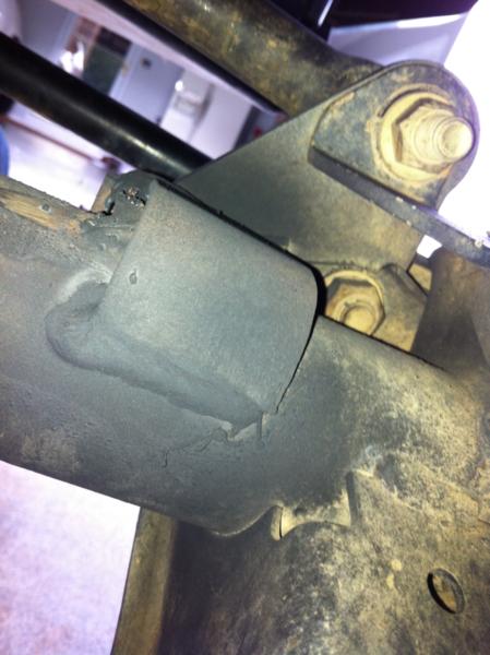

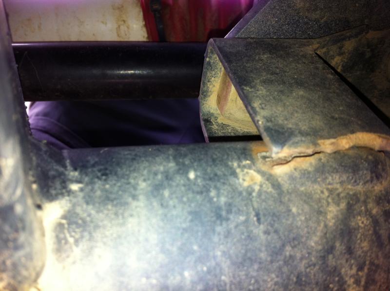

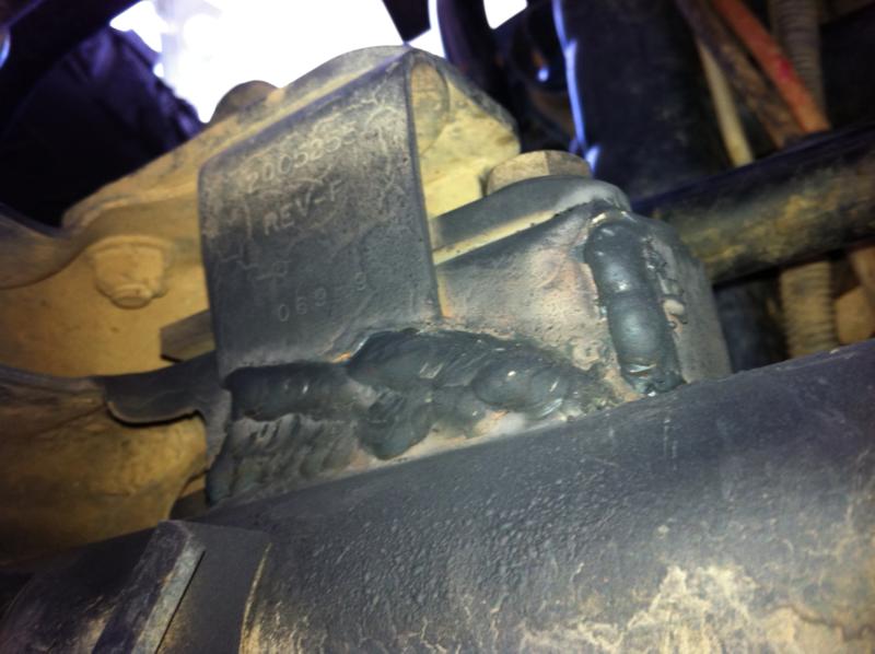

What should I do fix it myself or get the dealership to do it?

Old Jun 19, 2011 | 03:05 PM
4play's Avatar
Posts: 83
From: Avondale, AZ
I'd have a welder repair & reinforce it.
Old Jun 19, 2011 | 03:21 PM
Lomax-dtl's Avatar
Posts: 510
From: Dalton, Ga
How should i reinforce it
Old Jun 19, 2011 | 03:57 PM
chknkatsu's Avatar
Posts: 565
From: nyc
you can add some gussets to it
Old Jun 19, 2011 | 04:18 PM
Robar's Avatar
Joined: Nov 2006
Posts: 15,170
From: .
JKS makes both front and rear track bar braces:
Front Trackbar Brace
Rear Trackbar Brace
Old Jun 19, 2011 | 04:38 PM
riverrattcom's Avatar
Joined: Jan 2009
Posts: 15
From: Southern IL
Fix it with JKS Supports like posted above!
Old Jun 19, 2011 | 07:41 PM
Lomax-dtl's Avatar
Posts: 510
From: Dalton, Ga
Will it work with the bds Tracbar relocation bracket?
Old Jun 20, 2011 | 09:44 AM
aermotor's Avatar
Posts: 731
From: Los Angeles, CA
Is that the rear trackbar?
I had my front break. Took it to EVO where they grinded the whole thing off and put on a new, much better track bar bracket from Dynatrac. That's what I'd do instead of trying to repair the existing one.
It looks like my rear is going as well so I'll mostly likely do the same thing, take off the old one entirely and get the EVO one.
Old Jun 20, 2011 | 09:50 AM
Andrew@EVOMFG's Avatar
Sponsoring Manufacturer
EVO MFG Representative
Posts: 220
Hard to tell from the pictures but it looks like the front is failing. Either way...
Front steering kit with much stronger upgraded trackbar bracket at the axle.
http://www.offroadevolution.com/stor...O-DRAGLINKFLIP
Rear upgraded trackbar bracket
http://www.offroadevolution.com/stor...d=EVO-REAR-RCC

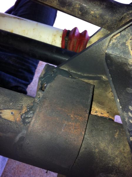

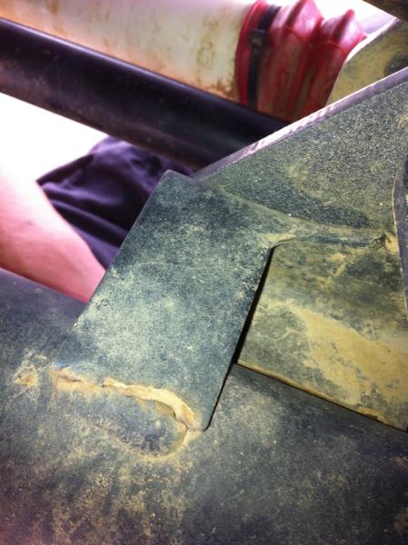

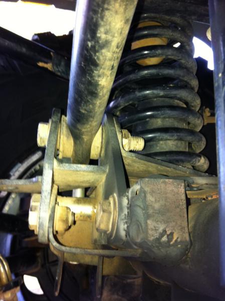

Old Jun 20, 2011 | 06:45 PM
Lomax-dtl's Avatar
Posts: 510
From: Dalton, Ga
Thanks but it's the front one but I got a friend of mine to weld it back on and he said that he could make a new bracket if it broke again. But here r some pics of it after he fixed it.
