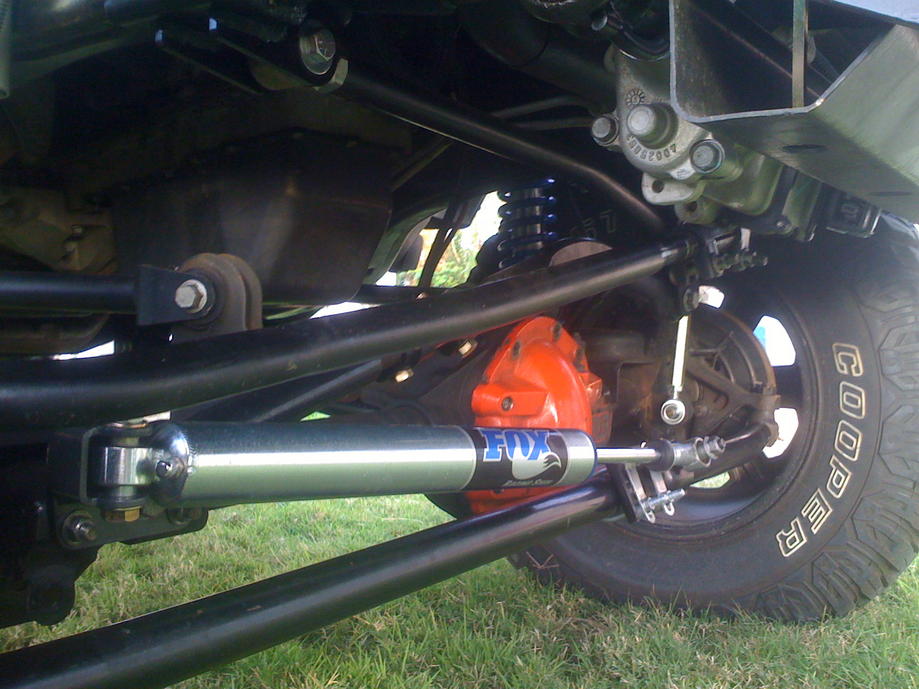

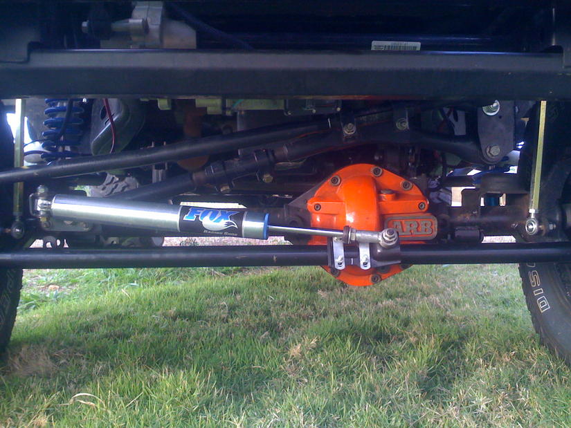

Here is a pic of my Teraflex HD Adj trackbar installed:
APPRECIATE THE BEEFINESS OF THE TB!

TF makes a very nice track bar and i would still be using the one i have if it actually had 4 bends in it like stock or a lot of the other manufacturers have instead of just one. unfortunately, this design prevents it from clearing my diff cover at a full stuff and so i had to replace it.
