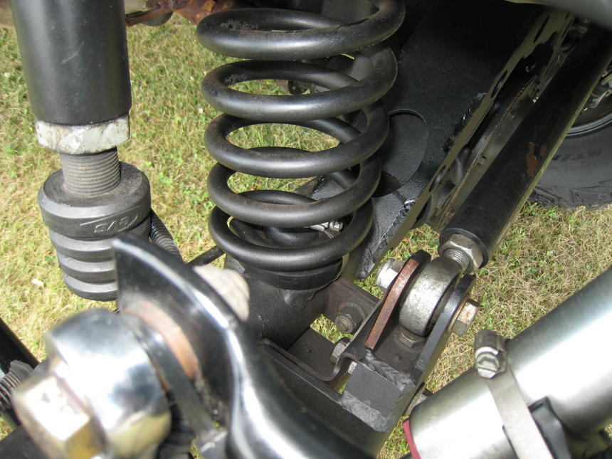

Track bar jam nut rubbing on spring

If you add our coil spring correction wedges to the bottom of your OEM spring seats that will help correct your issue and make your rear coil springs more effective.

That is a damn good idea. What is the longest the rear lower control arm should be? For some reason I am longer than Tera specs.

I had the same problem with an OME LT kit.
I ended up cutting off the spring perches and installing JKS adjustable spring mounts. No rubbing now.
Good luck.

I dont want to hide the problem if my lower control arms are too long.
