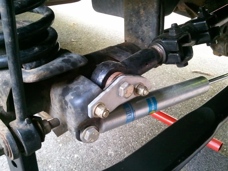

By the way. You should still pull your track bar and inspect the holes. Mine looked tight as well but when I pulled it the holes were way big. You can't really duplicate the forces that death wobble can put on your jeep. If they are big, its probably shifting.
I went the TeraFlex route:
Name:	2011-05-13 08.31.46.jpg

Originally Posted by F200
I had that same feeling, wobbled when the right tire hit a bump at highway speed. My drag link end at the right wheel was shot.
<img src="https://www.jk-forum.com/forums/attachment.php?attachmentid=159942"/>
So there is no welding on the Teraflex bracket? That doesn't shift and keep the hole tight without welding?
