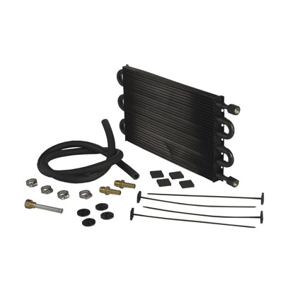

ok so went to do this "easy mod" lol last night.... opened the box.....wtf this doesn't seem right.Now i have a decent knowledge of some mechanics but this did not make sense to me. either there wasn't enough parts included or im an idiot that cant figure this out, either are probable.

Originally Posted by 09jku
Attachment 376894
That looks like a generic picture. Does it represent exactly what you received?

it is generic i pulled it off the internet because I forgot to take a pic of mine before work but yes it is the exact set up
I would say you are missing some barb fittings, and a couple hose clamps, then.
You will be cutting the return hose, so two double-ended barbs will go there.
Most people say some extra hose is needed, too.

that was my thought as well. i researched alot of uni kits and they all seem to have the same stuff in them so im not sure what there intent is on the install but it seems off
