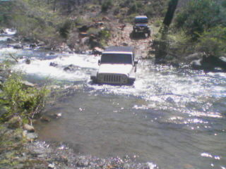

I went four wheelin drove threw a little water and now I am having transmission problems with my automatic. The tech thinks the transmission might have overheated and said these are really made for the road and if i do long four wheel drive trips i should buy a transmission cooler. It it still in the shop.
