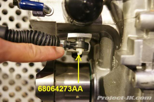

Does anybody have a picture of the piece that's keeps breaking

Here you go!

Originally Posted by OH9JK
Here you go!
Attachment 327775
Thank you

Ok so I wasn't sure what look for or where to look for it at. But what I did find that could have been the cable and transfer case appeared to be still connected. Is there another place in the cable set up that could have failed or am I just up the creek and have a ruined t-case?
Here you go!
Attachment 327775
It's a shame it isn't this peace, 46 cents at the dealer and the orange one underneath was $1.80
if I remember right. I just bought a couple extras, but have yet extend the cable loop to the next furthest floorboard hole.
This would make the cable so it don't shift so hard.

@ ky-wrangler the bushing pictured would not be visible under the jeep. That part is under the center console connected to the lever you move to put your jeep in 4x4. If you are looking under neath the jeep all should appear normal. Is there tension in your lever or does it feel like its not hooked up to anything?
