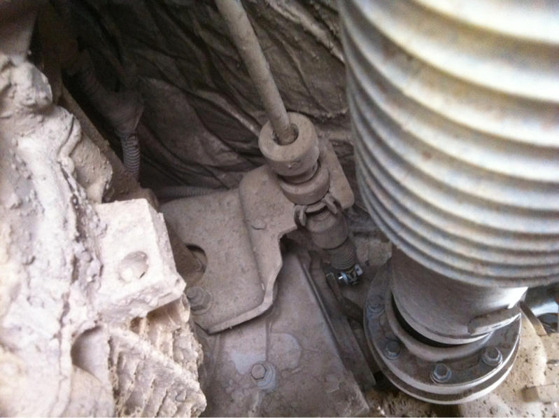

Thought I'd post a pic of that plastic clip installed on a not so clean jeep

From: Fonthill,Ontario
I have the advance adapters cable. It is a nice and sure replacement. It does take a bit of time to do but well worth it.
