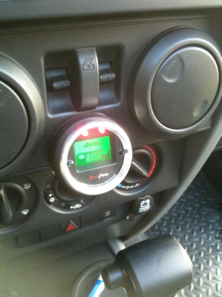

Could you tell me more about the Aeroforce temp gauge? Price, where to buy, how to hook up?? I would like to have a trans temp gauge and a real engine oil pressure gauge.

It plugs right into the OBDII Port an has enough wire to mount most places (From my photo I chose to mount it under my window switches). It can be set-up to monitor most any parameters you choose, mine stays on Tranny Temp an Coolant Temp. Bought mine for around $225 online, and it comes with an online toutorial on how to set it up.
these gauges are awsome arnt they, i love mine!!! i usually monitor tranny temp, coolant temp, and mph ... mph is nice because i can see my gauge alot easier than the speedo!!

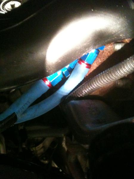

Make sure you use quality hose. I used lock-tite hose an aeroquip fittings (a lust of the exact things i used is pic'd with the quanity of each)
