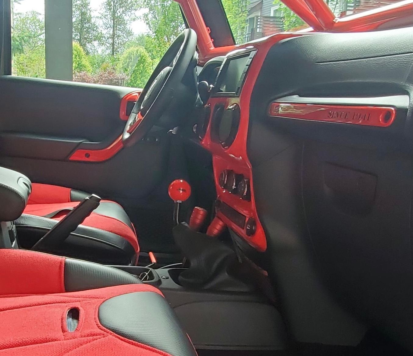

To avoid that ‘popping out of gear’ issue, I installed the B&M Short Throw Sport Shifter with the B&M Shifter Lever.
Completely different experience driving the JK now, shifting into gear feels very ‘positive’ and the throw is only about half (maybe less) than the factory. I wil say though - quite a bit of effort is needed to find some of the gears - nothing ya can’t get used to though .....
The B&M shifter lever is awesome - a bit shorter than the factory lever with a completely different contour.
