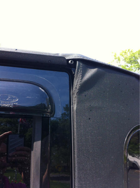

Just installed this top new on my 10 JK 4 dr. Did a little test with a hose and found it leaking here a little on both sides. I've been researching the forum but haven't found a direct answer yet. Do I have this installed correctly or any suggestions?
Thanks, it's supposed to rain here the next few days....

I would try snugging up the window after it sits in the sun awhile. There will still be a slight gap there by the screw. I haven't had an issue with mine leaking there.

Thank you. I opened it back up and resealed it. I guess I'll see if that works. It's on both sides in the same spot so in hoping it's "fixable".

If I kept the bar that came with the kit, I had an inch gap even with 90+ and sun. I had an old soft top and stripped the bar and 2 clips out of the rear window and it sealed up nicely instantly. I don't know if 110+ degrees would make the original bar seal up.
I have to figure out the problem at the top of the "c" pillar. I found the water coming in from the inside of the door surround.

it looks like it has to be pulled down some in that area, window looks to high, I had a similiar issue with my super top re adjusted it by putting that end in first then worked the zipper & velcrow while making sure it stayed in place, then did the bottom last. now it sealed up, hope this helps

I had this problem and I fixed it with some adhesive weather stripping from home depot. It's squishy foam, and I stuck it to the plastic pillar just behind where the soft top corner is. I also put some of it on the plastic trim piece while it was folded, the straightened out the trim piece, compressing the foam and creating a better seal.
On a side note, I had to get a warranty-replaced corner panel, and the new piece has a rubber weather seal sewn into the top that does a good job of sealing out the water. Apparently, bestop realized the problem and created a fix (I also heard that the newer trek tops come with a factory style tailgate bar?). Perhaps you could complain to wherever you bought it and get two new panels?
