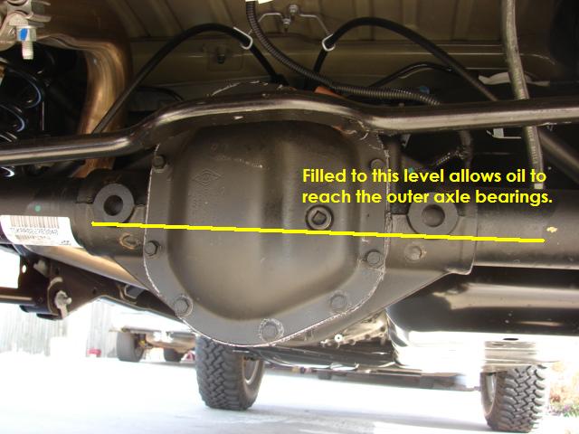

Autozone has a pump that screws into the bottle and a hose the goes into the fill hole. Think its like $4. It will take a while but it will get the job done
Writeup shows amount required on the left: http://project-jk.com/jeep-jk-write-...hange-write-up

Searching thru the write up section, the front takes 1.35 quarts and the rear 2.375 quarts

Each aftermarket diff cover is diff, so the amount of fluid is going to vary. I just filled then until the fluid started coming out of the hole (haha, I know)...
