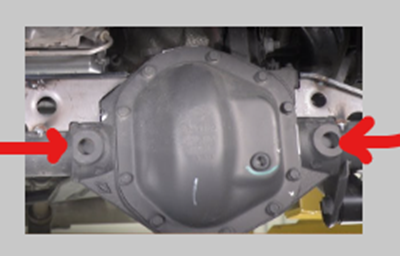

I’m just thinking out loud here (ie, possible random rambling). I have a hard time seeing how a C could twist around the axle tube due to an accident, and if anything I think if it was possible the more likely result would be it would twist backwards and increase the caster (running into something or being hit from the side….you’re not really being hit from behind the front wheel with forward momentum). I also find it hard to believe the front axle tube twisted altogether. You can look for signs here at the diff –
I find it much more likely that control arms would bend or even that the axle tube would bend with enough force. As Sixty4x4 points out, it takes a s-load of rotational force (usually from high torque and HP) to twist those tubes pressed into the pumpkin or even a C onto the tube…..but I guess anything is possible and I certainly have no expertise in this area. I suspect the mismatched adjustable control arms might have been an attempt by the previous owner to correct some of this.

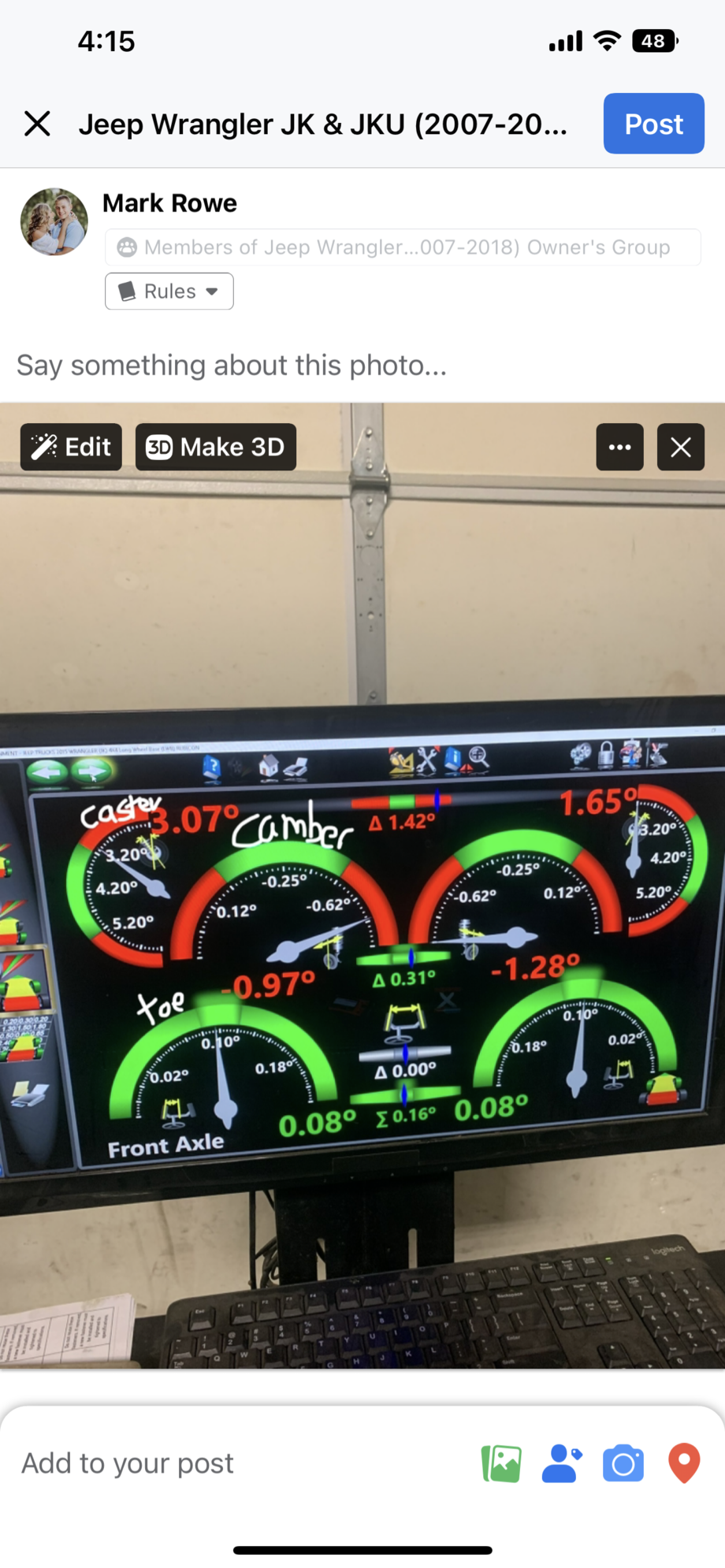

I’m curious to see the alignment printout. With all the bad parts you’ve mentioned, I question whether the shop you used was any good. A good alignment shop will take 20 minutes and inspect the ball joints and rod ends to make sure the axle is solid in the first place.
I wonder what the thrust angle is between the front and rear axle. Did the alignment shop square the axles to the vehicle? If not, and if your front axle isn’t straight to the rear axle and the frame, then you could potentially see a difference in the caster since one side would be further forward than the other resulting in that difference.
I do agree with @resharp001 that the axle tubes aren’t likely to twist like that.
Start by getting your control arms and ball joints in order, then find a better alignment shop.

Old Nov 29, 2022 | 04:07 PM

Maybe I’m not up to speed with how these machines work but I don’t understand how he can tell anything about the caster when the camber is out. Someone correct me if I’m wrong but isn’t the caster measured by a difference in the camber from -20* to 20*? So if the camber is out, the caster wouldn’t be measured right.

I didn't know that you could do that. I thought the caster was the forward or backward angle (looking at the side) and the camber is the tilt left or right looking from the front.
