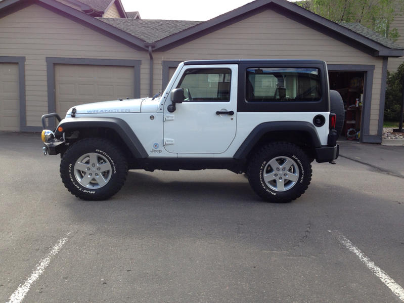

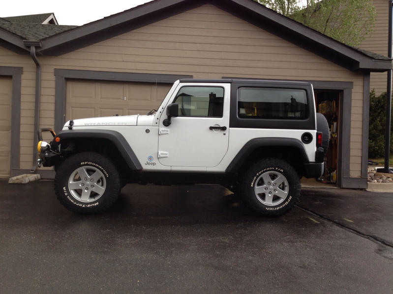

Mine rides much better now, smoother. I went up the same numbers, with the Rubi shocks. I also have a heavy bumper and winch as well as a heavy skid plate. I gained about 1.25" with the bumper/winch. I would have went up over 2" easy with no bumper combo. Pics are before and after.
