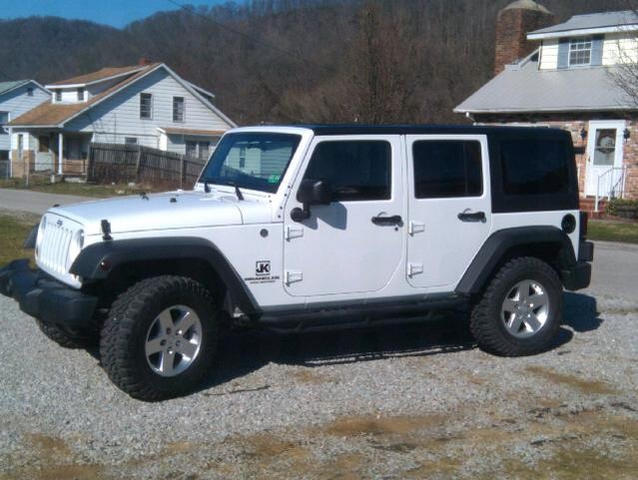

Here's a pic of mine with the 1" front coil spacer and 285/70/17's.

Nice. How's yours with rubbing?
Full lock only, no other issues.
