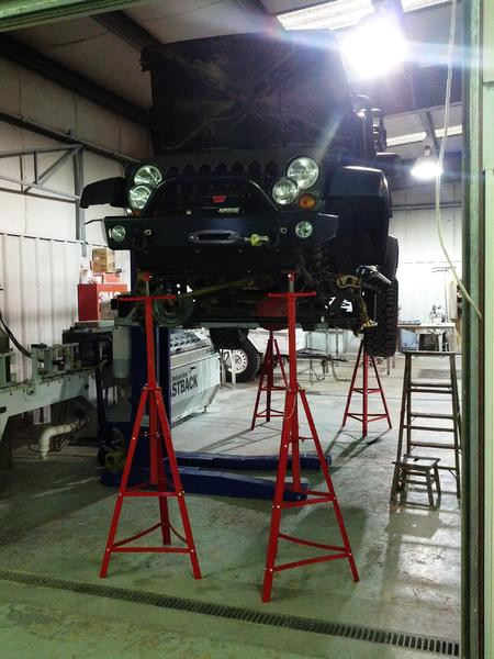

Putting the jeep on stands is not that much different then tires so keep your stands near the end of the axle the best way you can for stability
My jeep has been on stands many times but here is an idea of what I was saying

If feasible for the work you're doing, place your tires where they would catch the Jeep should something go amiss. It will make you feel a little more comfortable. As for stand rating: I use 3 tons and would not want the Jeep any higher. I get tired having to work with my arms stretched out even further. But that would depend on the job. At the end of the day, having a friend with a lift is the best thing, LOL ...
Name:	Jeep Work, Jan 13, N7-3458, On Lift.jpg
